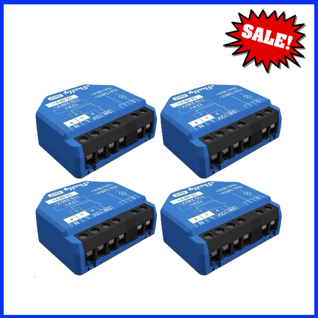

I just added a Shelly Relais between the Room thermostats and the valves. This is very cheap and super easy since you usually have a lot of space where your valves are located.
In OH I can even decide whether my OH should control the heating or my room thermostats that are still connected to the valves as a switch to the Shelly (usually this is not required but this would keep stuff working if my OH system would be down for a couple of days due to broken hardware). Just make sure that you override the room thermostats decision when your own logic has a different opinion on heating requirements.

I’m thinking of adding a shelly wifi relay to handle on-off for each zone based on input from temp sensors I already have in place. Because of the long lag times with in floor heating I think this approach might be sufficient. If not a smart thermostat in each zone might have to be the proper solution.
(Just saw DrRSatzteil post, sounds exactly like what I’ll be setting up :), essentially using shelly’s to jump the thermostat input on demand by OH. Works for gas fireplaces too)
You mean something like this?
Yup, except I already have the valve controllers in place to actuate the valves based on a mechanical thermostat in each zone, but the functionality is just like what you’ve outlined.
Something like that would also work I assume (Actually I prefer zigbee over WiFI):slight_smile:

EDIT: Or this:
