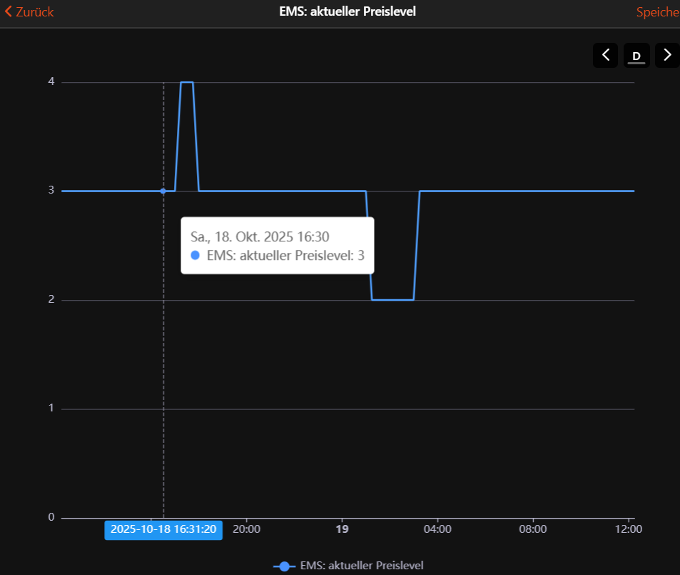

The corresponding chart looks like this:
but the item itself still has some state given to it (via postUpdate without the persist-stuff) a long time ago? It still has the value 5 despite having the chart telling me it should have 3…
Do I need to configure something or doesn’t it work that way?
