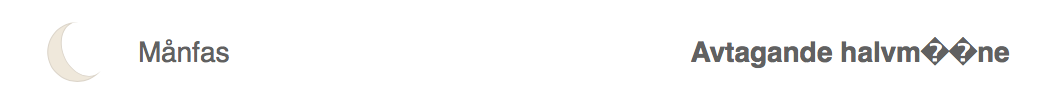

I’m trying to use MAP and transformation files to translate values to swedish, but for some reason this doesn’t work. First I thought it could be some problem with unicode in the BasicUI, but it works as it should when I use the swedish characters directly in labels.
The Swedish character “å” is presented as it should when in a label, but not when used in a map-file. I get the same result when using Safari on Mac, Chrome on Mac, Safari on iOS or the native OpenHAB-app on iOS. Is this a known limitation or am I doing something wrong?

Ok, thanks. Obviously platform dependent. I thought I was missing something after reading the thread below but I will try the method with unicode escape characters. Seems like the best way is to convert the file using the native2ascii tool.
