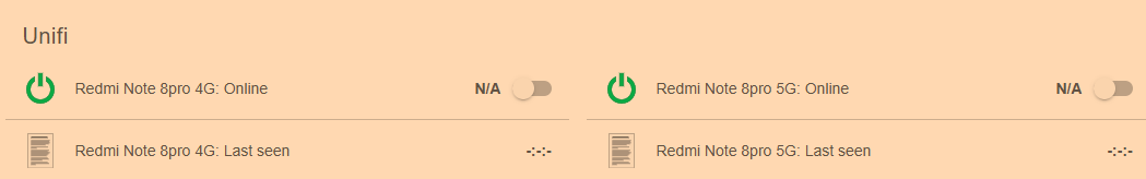

I hope someone can help me with oH3.2 and Unifi Binding:
(The Unifi controller software is running on Proxmox VM)
The log says:
2022-02-17 20:04:58.784 [INFO ] [ab.event.ThingStatusInfoChangedEvent] - Thing 'unifi:wirelessClient:home:phoneDirk5G' changed from INITIALIZING to ONLINE
2022-02-17 20:04:58.811 [INFO ] [ab.event.ThingStatusInfoChangedEvent] - Thing 'unifi:wirelessClient:home:phoneDirk4G' changed from INITIALIZING to ONLINE
But there is nothing in the sitemap:
THINGS:
Bridge unifi:controller:home "UniFi Controller" [ host="192.168.YYY.XXX", port=8443, unifios=false, username="wifiadmin", password="qwertz", refresh=10 ] {
	Thing wirelessClient phoneDirk4G "Smartphone 4G" [ cid="XX:XX:XX:0D:61:CC", site="default", considerHome=180 ]
	Thing wirelessClient phoneDirk5G "Smartphone 5G" [ cid="FF:FF:FF:61:AA:DD", site="default", considerHome=180 ]
ITEMS:
// Smartphone 4G @Unifi
    Switch     SmartphoneDirk4G_Online       "Redmi Note 8pro 4G: Online [MAP(unifi.map):%s]"           (Gunifi)      {channel="unifi:wirelessClient:home:phoneDirk4G:online"}
     DateTime   SmartphoneDirk4G_LastSeen     "Redmi Note 8pro 4G: Last seen [%1$tH:%1$tM:%1$tS]"                            (Gunifi)      {channel="unifi:wirelessClient:home:phoneDirk4G:lastSeen"}
// Smartphone 5G @Unifi
    Switch     SmartphoneDirk5G_Online       "Redmi Note 8pro 5G: Online [MAP(unifi.map):%s]"			(Gunifi)      {channel="unifi:wirelessClient:home:phoneDirk5G:online"}
    DateTime   SmartphoneDirk5G_LastSeen     "Redmi Note 8pro 5G: Last seen [%1$tH:%1$tM:%1$tS]"                            (Gunifi)
SITEMAP
sitemap test label="Test" {
    Frame label="Unifi" {
        // Switch   	item=SmartphoneDirk4G_Online
        // Switch     	item=SmartphoneDirk5G_Online
		Text   		item=SmartphoneDirk4G_Online
        Text     	item=SmartphoneDirk5G_Online
        Text        item=SmartphoneDirk4G_LastSeen
        Text      	item=SmartphoneDirk5G_LastSeen
MAP
ON=Home
OFF=Away
-=N/A
