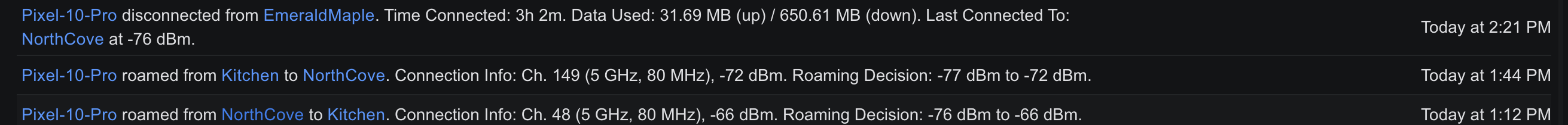

The unifi log for the same period doesn’t show a corresponding event (unfortunately it is displayed via a bunch of table cells and doesn’t format well when cut/pasted, so I’m using an image)
(the disconnect at 2:21 was forced in order to see how it would react)
