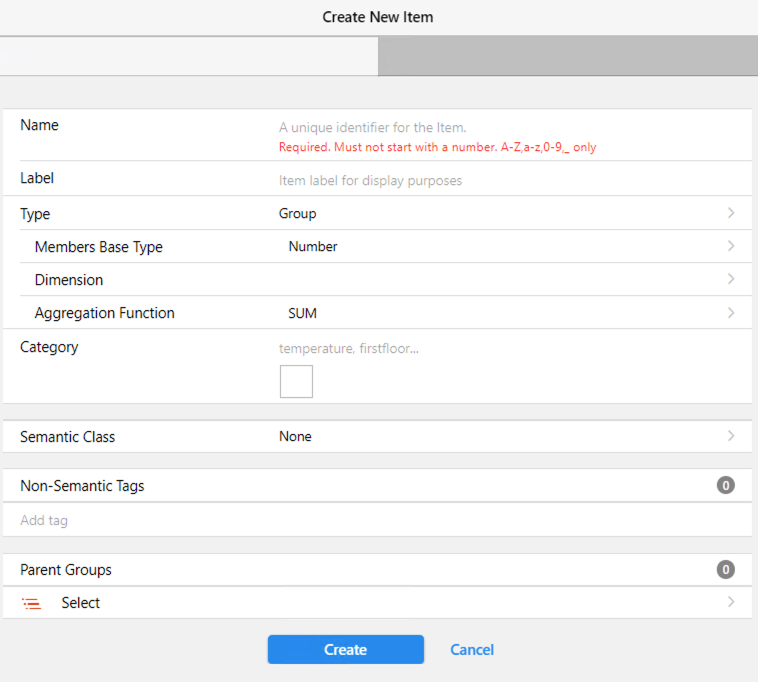

That’s not how it works. This approach will never work. Channels do not interact with each other even with profiles. They can’t see each other so there’s no way they can sum up all the values.
Link each of the four Channels to separate Items. Put those four Items into a Group of type Number with an aggregation function of sum.
At a high level, on Settings → Items click +, choose “Group” as the type, “Number” as the member base type and “SUM” as the aggregation function.
