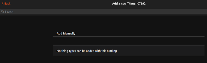

I am using OpenHab 4.0.2 and installed the binding from the marketplace. When trying to add a new thing the page remains empty:
Restarting OpenHab and re-installing the addon did not help. Still the same. The logs are not showing any issues. Did anyone encounter that and knows what to do?
I have the same problem
Not sure why installing the addon via marketplace is not working.
I have submitted a bug on openHAB Core. Installing the binding manually (same jar as provided by marketplace), is working.
Addon is fixed for marketplace now by renaming the jar-file.
