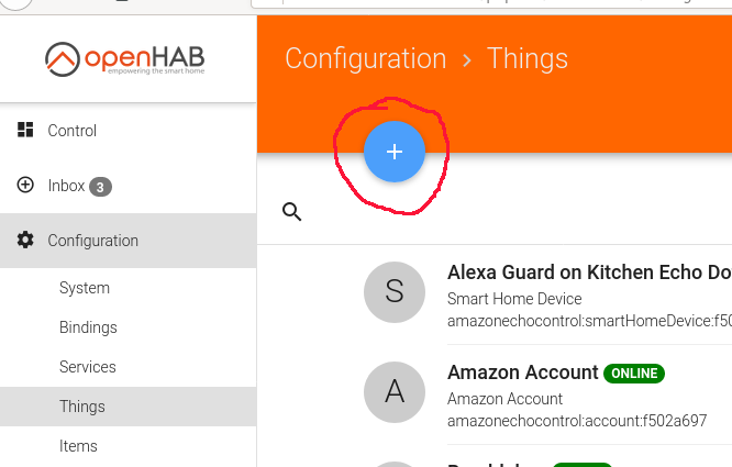

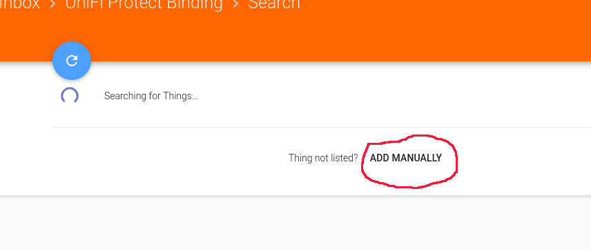

OH2 PaperUI Setup:

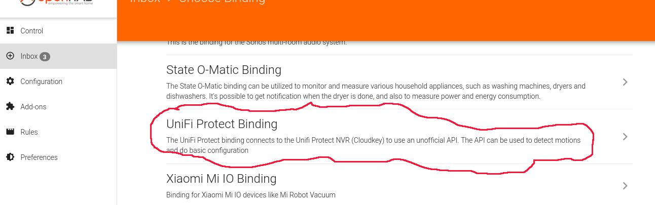

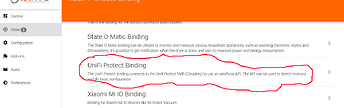

Add new thing as per below:
Select correct binding

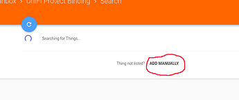

Select to add a nvr manually (bridge)

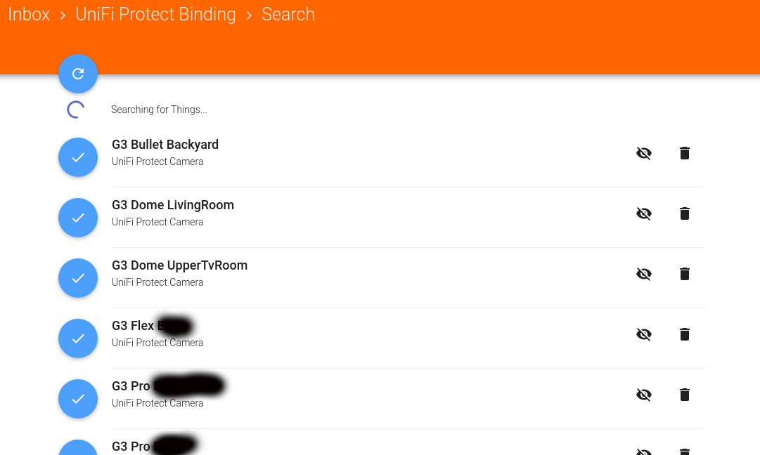

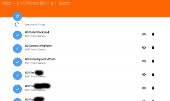

Cameras should be able to be discovered without manually adding them:
