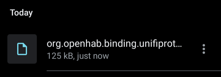

If it helps, clicking the Download button on the link in your post gives me a 125kb file:
Screenshot_20201203-210831

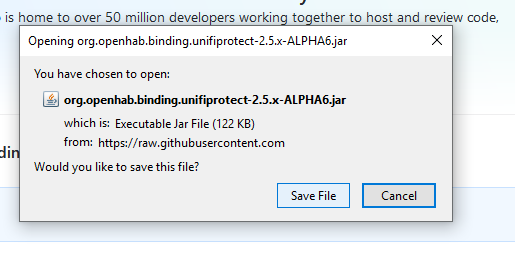

If I download the file (windows-client) - I’ll get a 95.174 byte-file
this is my result:
-rwxrwxr-x 1 openhabian openhab 95181 Dec 3 22:17 org.openhab.binding.unifiprotect-2.5.x-ALPHA6.jar
That’s strange - why is the size always different?
windows 10
I’ll try zipping it and upload it to gdrive then :slight_smile:
finally I got it!
Anyway - strange, that I got different sizes and it didn’t worked from linux directly. But now I see the binding in the console…

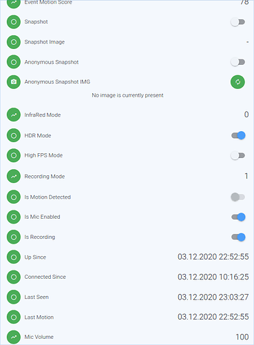

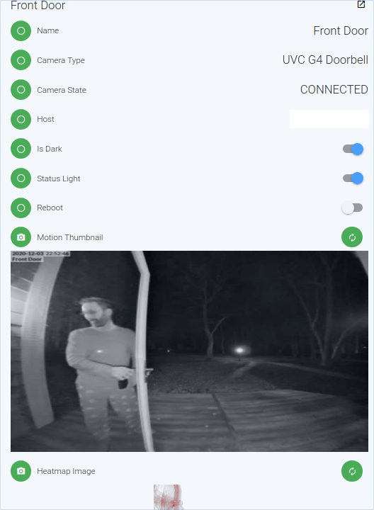

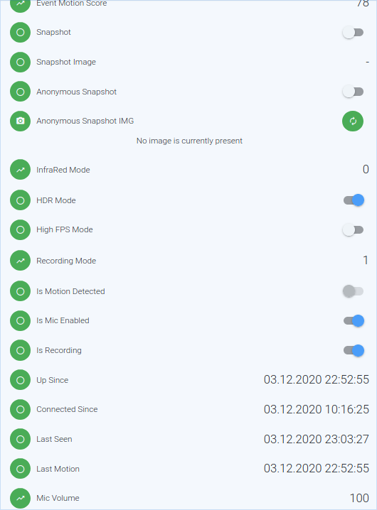

Screenshot from 2020-12-03 23-22-54
Screenshot from 2020-12-03 23-22-19
