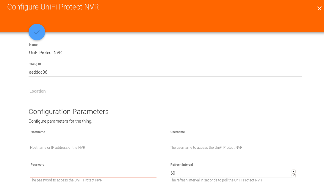

It should be the bridge thing id. If you use the UI to manually add the bridge it will generate and Id for you, but you can also specify the id yourself. For instance my id is: e7d2e32c
I recommend you use PaperUI for openhab2 to add things. Items can be configured manually.
I’m not adding ā€œthingsā€ manually, but I can give it a go if you see the need.
Please try and use the GUI to add things, you will get discovery as well, and in the end you are less likely to make errors in your configuration.

The bridge is configured in OH3 like following:
UID: unifiprotect:nvr:UnifiProtectNVR
label: UniFi Protect NVR
thingTypeUID: unifiprotect:nvr
configuration:
  host: 192.168.2.XX
  refresh: 60
  password: My-Unifi-OS-pwd
  thumbnailWidth: 640
  eventsTimePeriodLength: 30
  username: My-Unifi-OS-user
As an example one of the linked channels is:
unifiprotect:nvr:UnifiProtectNVR:name
