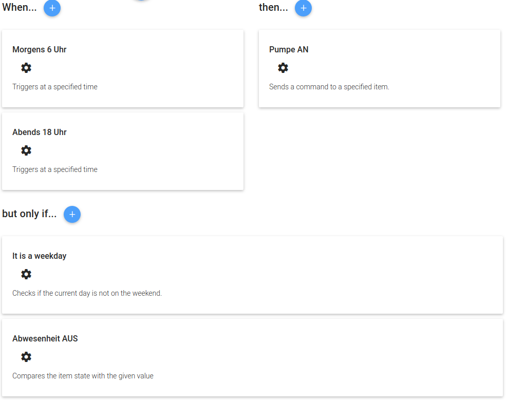

Thanks for the detailed explanation! I narrowed it down to the following error message in the events.log:
a1e15e08-5d3a-4212-abf1-bccde107cfba updated: UNINITIALIZED (HANDLER_INITIALIZING_ERROR): Getting handler ‘ephemeris.WeekdayCondition’ for module ‘3’ failed: Config parameter ‘offset’ is missing in the configuration of module ‘3’.
Actually I haven’t set an offset value (thinking it will default to zero), but even after explicitly setting the offset value to 0 (or 1) doesn’t help. Here’s the rule config:

For the time being I’ve created the following rules on a file basis:
