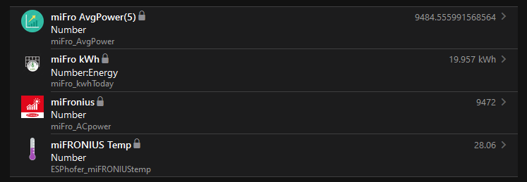

I’m little confused as I undeerstand that the problem is an item with the unit W and a number without any unit to be subtracted. However my AC_power items are all without units. Have a look. i would expect a unitless item to be able to be subtracted from a unitless value of 400. but i guess i’m wrong, otherwise it would work…
If the item is not dimensioned, then try this:
var AvailChargePower =
(miFro_ACpower.averageSince(now.minusMinutes(2)) as DecimalType) - 400
The averageSince now returns a State instead of DecimalType.
The difference is that DecimalType is a direct descendant of Number, so you can treat it like a Number and apply subtraction - directly, whereas a State is just an interface that DecimalState and QuantityType implements. So a type cast is required.
This change doesn’t affect jruby but it does affect DSL. Not sure whether it also affects jsscripting (@florian-h05 ?).
