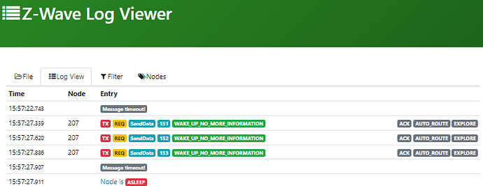

That is inconclusive. First it is best not to filter, messages without the node number can be important. Second the log started 4.5 seconds after the button was pressed.
Also the state Request_NIF doesn’t refer to the initialization steps. Not sure what to advise except try again.
I’m having problems figuring out how the log viewer works. It seems to not run in real-time; messages’ timestamps suggest they come in only a few hundreds of seconds apart at random intervals but new lines appear in the viewer with what appear to be regular intervals and clearly a lot slower than that. I’ll give it another try in a bit.
Assuming you are talking about the UI version. I’m old school. When you set the binding debug, the items will appear in the openhab log. You can then load that into the Zwave log viewer referenced above. (non-ZW messages are ignored). Your first snippet just shows this.
Neo 2025-07-19 114359
The timeouts could indicate a communication issue since the device was awake at that point
