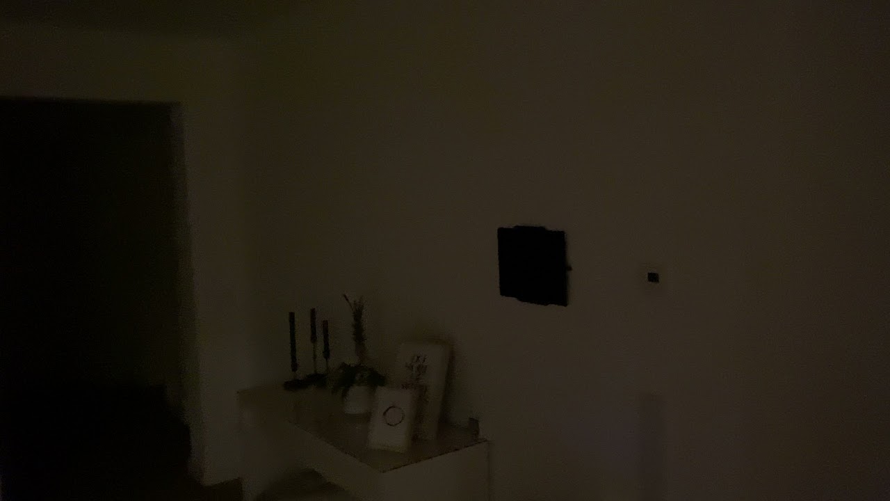

Set up the guided access in iOS for your openhab app or browser. If now the iPad receives the push notification from your sensor, the screen will light up, but the notification won’t show because of the guided access.
Looks like this:
