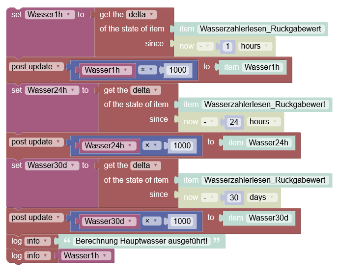

I am running openHAB 3.3 with openHABian and I have programmed the following rule which is triggered by any change of the water meter. It shall calculate the water consumption for 1 hour, 24 hours and 30 days:
This rule works fine with the 24 hour and the 30 days calculation. However, the 1 h calculation only works correctly if I run the rule manually. Otherwise I regularly get a value of 0 for water consumption last 1 h. I did some tests. It seems that often the automatic calculation returns “null” for water last 1h.
My persistence service is rr4dj with default settings. Any ideas what could be wrong?
Just a guess, your rule triggers when the item state changes. In that event the changed state might be scheduled to be persisted ( your default rrd4j settings should ensure that) and your rule gets scheduled to be run. Both could happen in seperate threads, which one is run run first can not be predicted. So you might run into a situation when the obviously changed item state is not yet persisted but the rule is requesting the change of the last hour. Since the last value is not yet persisted the rule will show a value of 0.

thanks for your help. I did run the rule every five minutes before I changed to the trigger water meter change - same problem.

That’s probably another story (read Here). My guess would be that you have gaps in your rrd4j database. You could check that with the API explorer, look for the ti eframe which givesyou a ‘null’ return ( note that the API explorer uses the 24 houres as a default timeframe).
I did some further testing (with my means). Unfortunately I am not an expert in this.
I created a script which logged the following output: Wasserzahlerlesen_Ruckgabewert.historicState(now.minusHours(1), "rrd4j")
I ran it serveal times and it always gave me the correct answer, never “NULL”.
It seems as if I have found a suitable workaround.
I run the rule every five minutes (starting 2 min. past the hour), in addition to the trigger water meter change. I added a delay of 2 sec. before the rule actions starts. It now seems to get reliable past values for the calculation.
