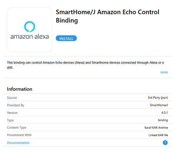

The strange thing is it only offers me an old version 4.3.1 for installation.

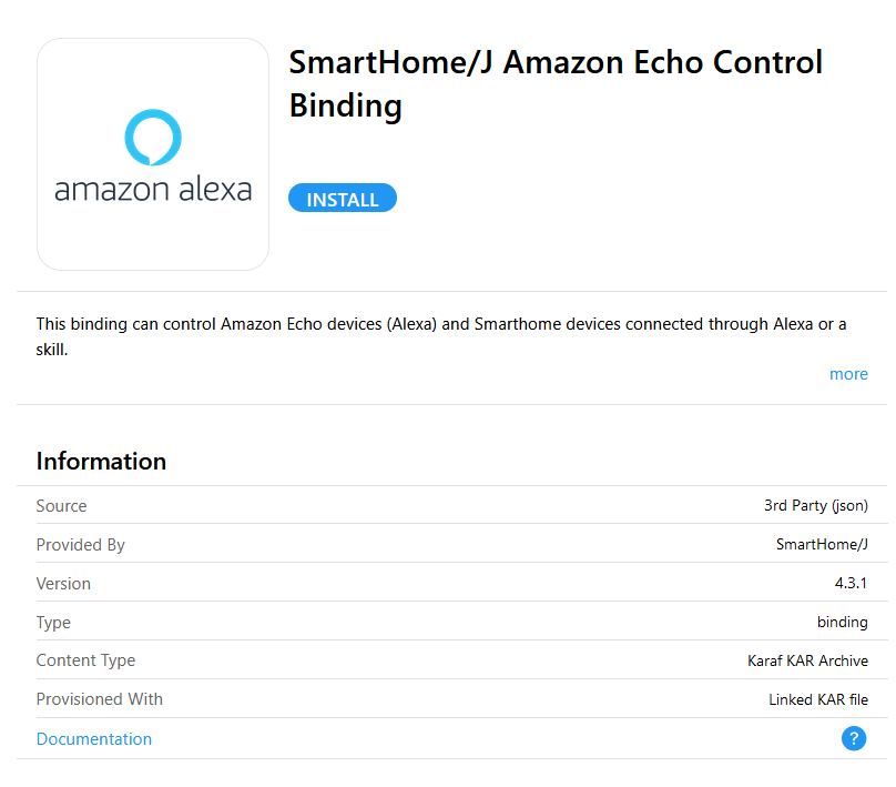

Meanwhile I did a clean, vanilla install of openHAB 4.3.2, I only configured smarthome/j as 3rd party addon:
Only amazon echo control binding version 4.3.1 is offered for installation
That’s correct. You should not see the Exception with that version.
I had some internal misunderstanding about the version numbers, sorry for wasting your valuable time. :innocent:
