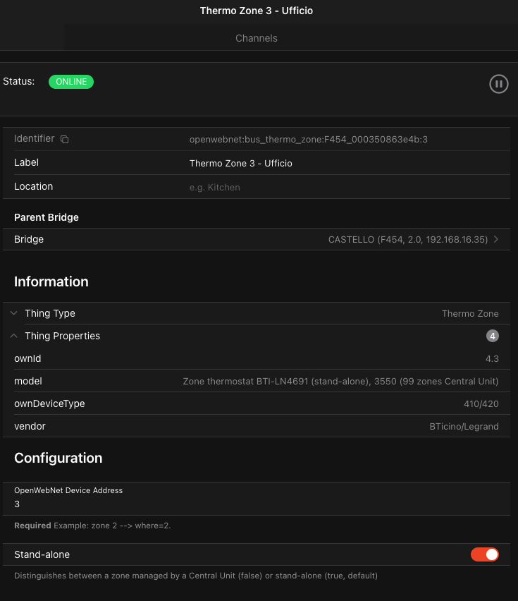

This is my thing

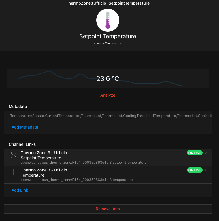

This is my item

I Think you have errors in your configuration. For example you have two different channels linked to the same temperature item (you should have an item for set temperature and another one for current temperature).
You should also have a item to represent the thermostat status linked to the mode channel (which is a string channel).

On OH3 i set all my Zone as standAlone: false because i have a 3550 central unit.
