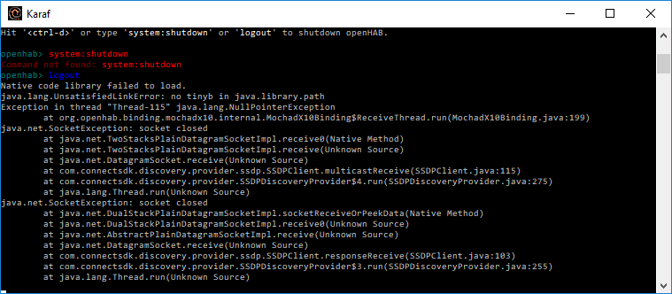

Also have this problem with chocolate package installation, even when I try to shutdown the system. As the systems requires to shutdown the system before launching the update process, this is something like a deadlock.

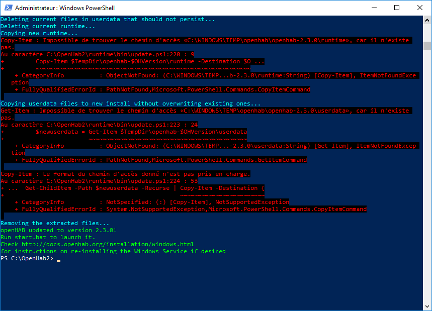

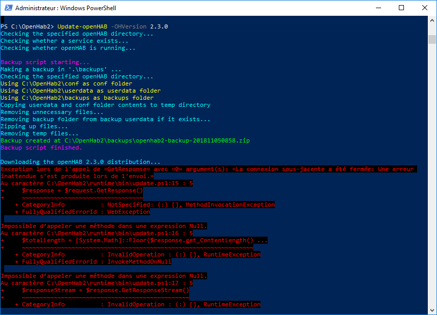

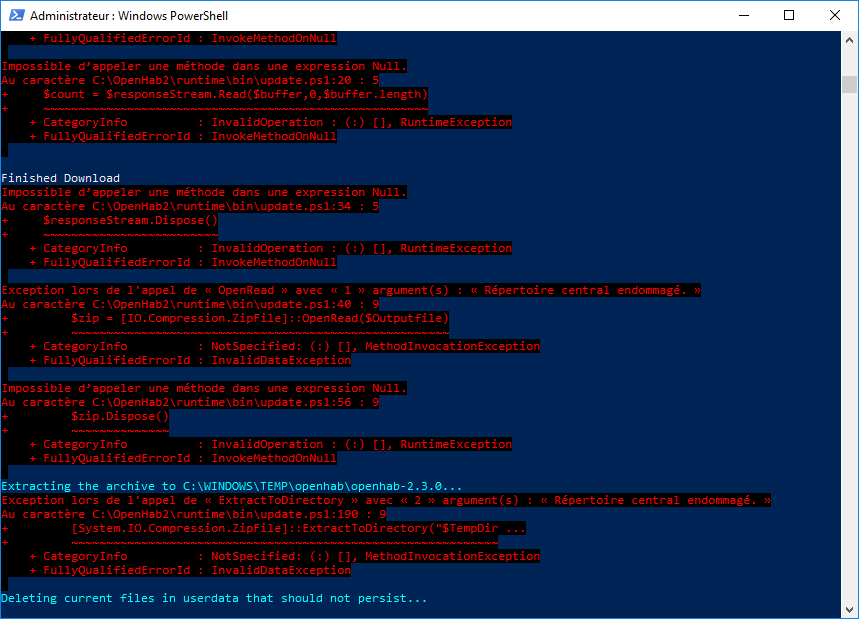

After exiting the console, I can launch the update process, but hae the following errors, maybe it helps…
And finally it’s running despites all these errors, but what I find strange, is that by default, ALL Addons.. bindings are installed by default, is this normal?
