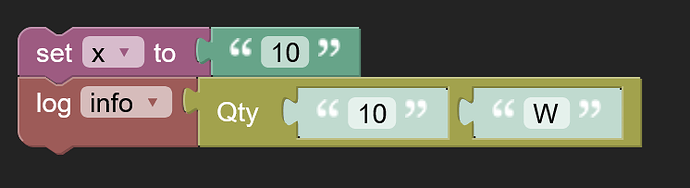

Given this:
Will generate this code:

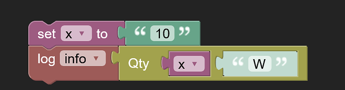

Why does this:
Generate undefined:
And, how to I work around this? My example is iterating values and checking if any exceed a threshold.

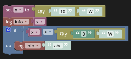

As I was only experiencing problems with my initial variable set, as illustrated here, the way to achieve this is to type the initialisation:
Which gives:
So this doesn’t really answer the question, can you use a variable in a quantity (no), but it does provide an alternative approach to using quantity with variables.
I’ll note that you can then legitimately go on and do this:
Or even this:
I’d therefore suggest it might not be a bug, just a consideration - the bug may be allowing a variable in the quantity shape at all. I feel that’s one for the authors to ponder!
