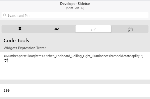

Actually, the first suggestion of using split hasn’t worked. I think there’s a bug in here. It’s acting very strange. A simple expression of if A < B then color green. As I incrrease and decrese the A value, I get green randomly.
You intend to do a numerical comparison, yes? Remember that Item states arrive here as strings, not numbers. Splitting them results in strings of digits, not real numbers. Parse the strings to get numbers.

Well, there’s the fix, as recommended by the guy who wrote the UI. What will you do now?
That works, thank you.
But it still doesn’t explain why I need to do this with Illuminance numbers and not temperature numbers. It reads like it shouldn’t work with temperatures either, but like I said, my heating system UI changes through blue, yellow, orange, pink, red as the temp rises and it works perfectly.

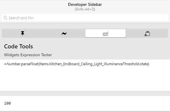

I seem to be able to get numbers from the Developer Sidebar by losing the split bit, but it doesn’t work in my UI expressions
Why, what are you doing with it? What does ‘not work’ mean happens instead? Tip, now it is parsed to a number don’t try comparing to some other string like “20”.
