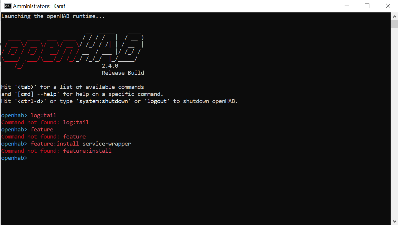

As you can see in the picture, i cannot use openhan even if is started… no command work and i cannot access web UI.4

I have deleted every file you listed (and listed in the update page too) except for “org.openhab.addons.cfg”, i haven’t in my etc folder :confused:
After that, i have extracted the zip without overwriting files (36 skipped)…
That’s it… :frowning:

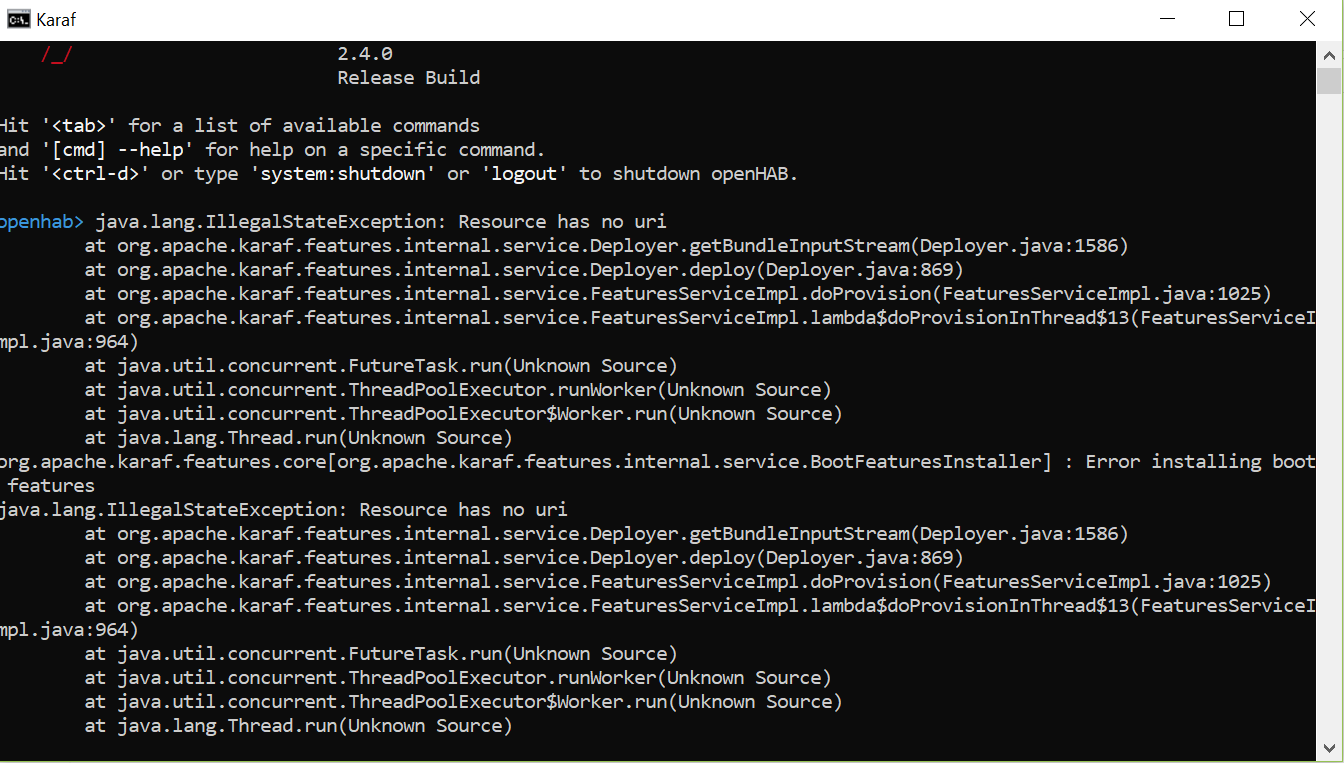

If you wait half an hour, does it ifx it? On my first start after upgrade it takes a while for OH to be well prepared. It looks like some files were downlaoded and a lot of caches are filled. After a while I can enter log:tail and the command is recognized.
now that o.O4
after all these errors are you able to enter log:tail?
Nope, i have deleted again the files and extracted again 2.4 and now is working o.o
