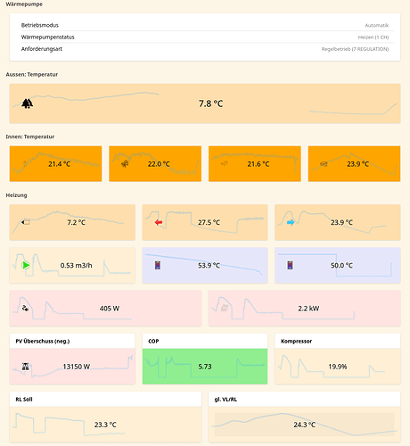

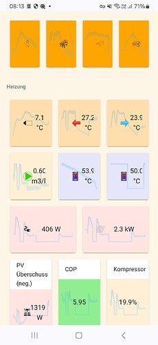

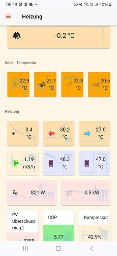

I just updated from 4.3.1 to 4.3.3 and now (almost)? all UI elements are significantly larger. Well, I tried to get many charts, lists and cards in a space-efficient way on my pages before this update, and now they are even larger than before. Is this a bug, a config error on my side or just intended behaviour?
New UI:

But I’m pretty sure the size of e.g. a label with chart used to be like the inner rectangle you can see here (first row, second column):
This rectangle is shown when the mouse pointer is above the element, so it’s like highlighting the inner part of the element, and that didn’t happen before the update at all.
It could also be possible that all elements have the same width, but increased height.
The underlying construction of the OH card widgets did change recently (although I can’t recall if that was between 4.3.1 and 4.3.3). That change was not intended to have an impact like you are describing, but if you have put in additional styles or stylesheets on this page, then those could certainly be a potential issue.
If you show the full yaml configuration for that page we might be able to pin-point where the issue is.

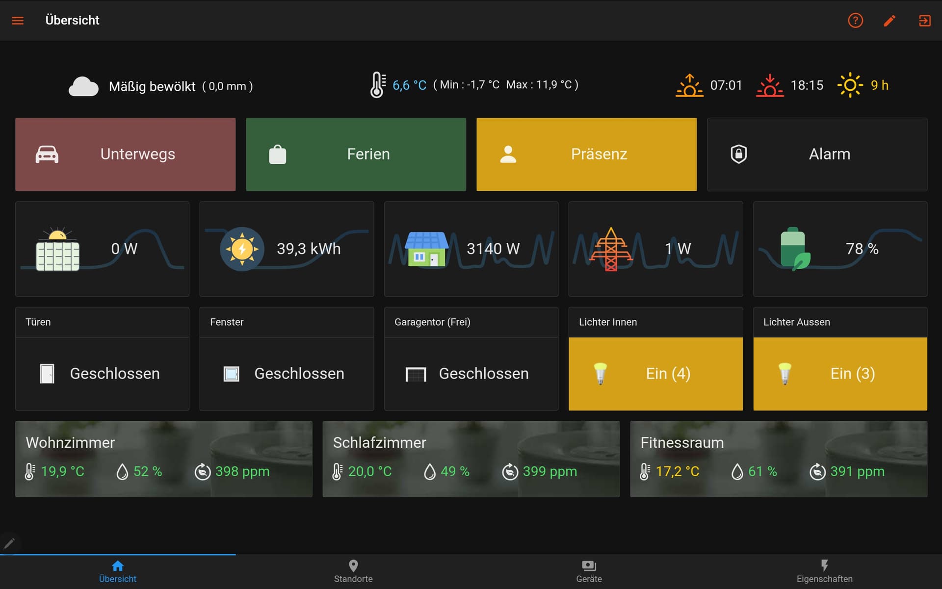

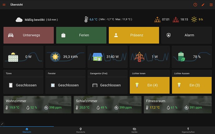

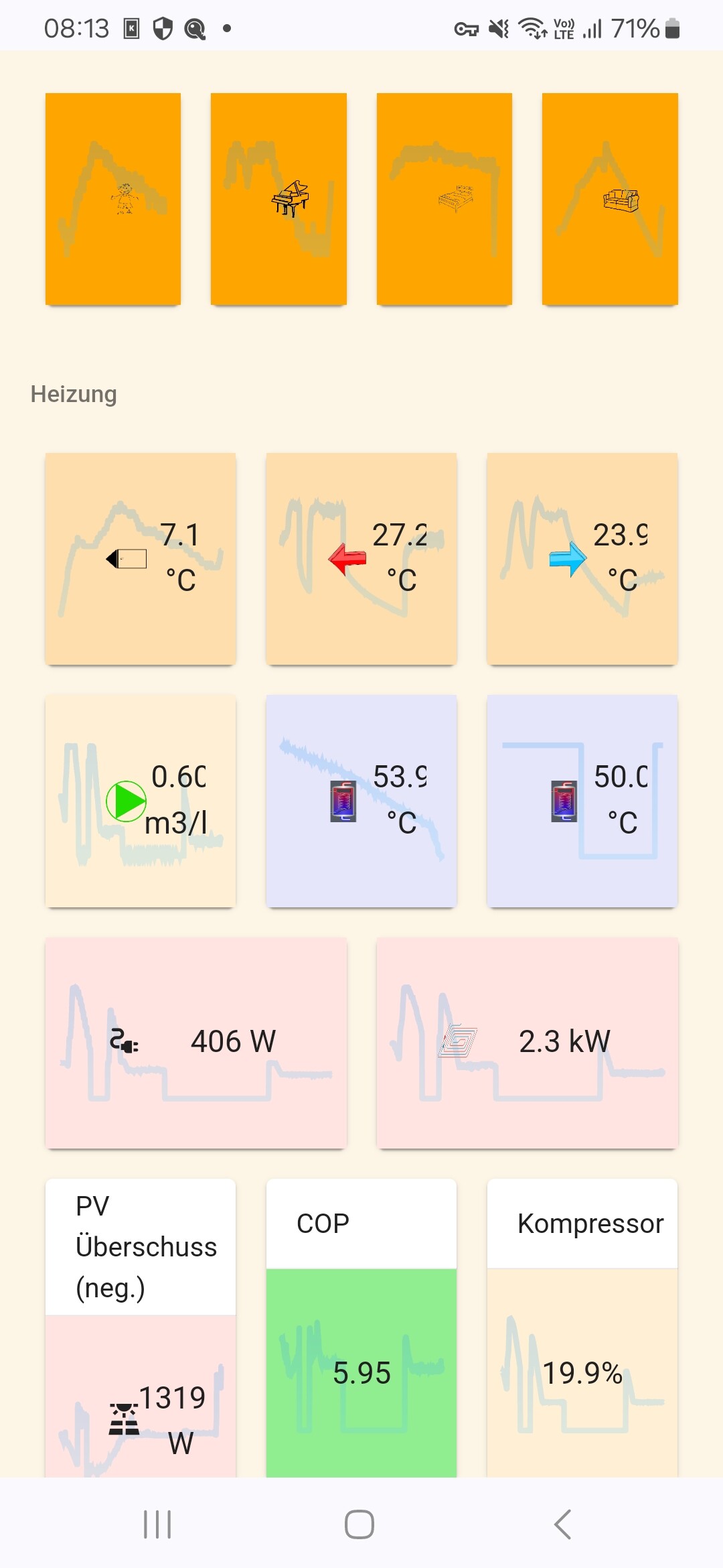

Here before and after:

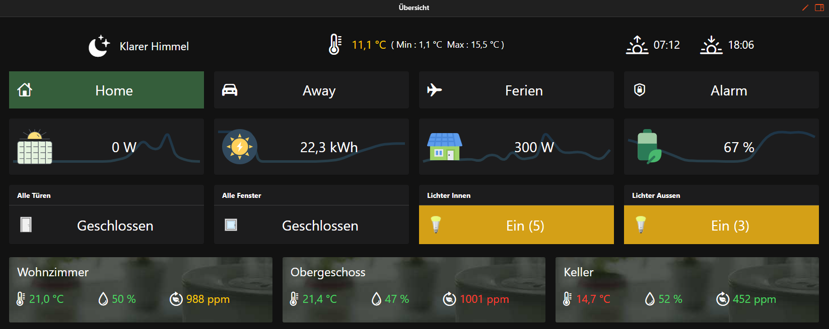

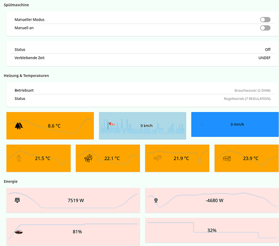

In OH 5 Milestone 1 I did not see this and I don’t think I have additional styles or stylesheets.
So this is a bug, or a “feature” just not landed in OH 5 yet?

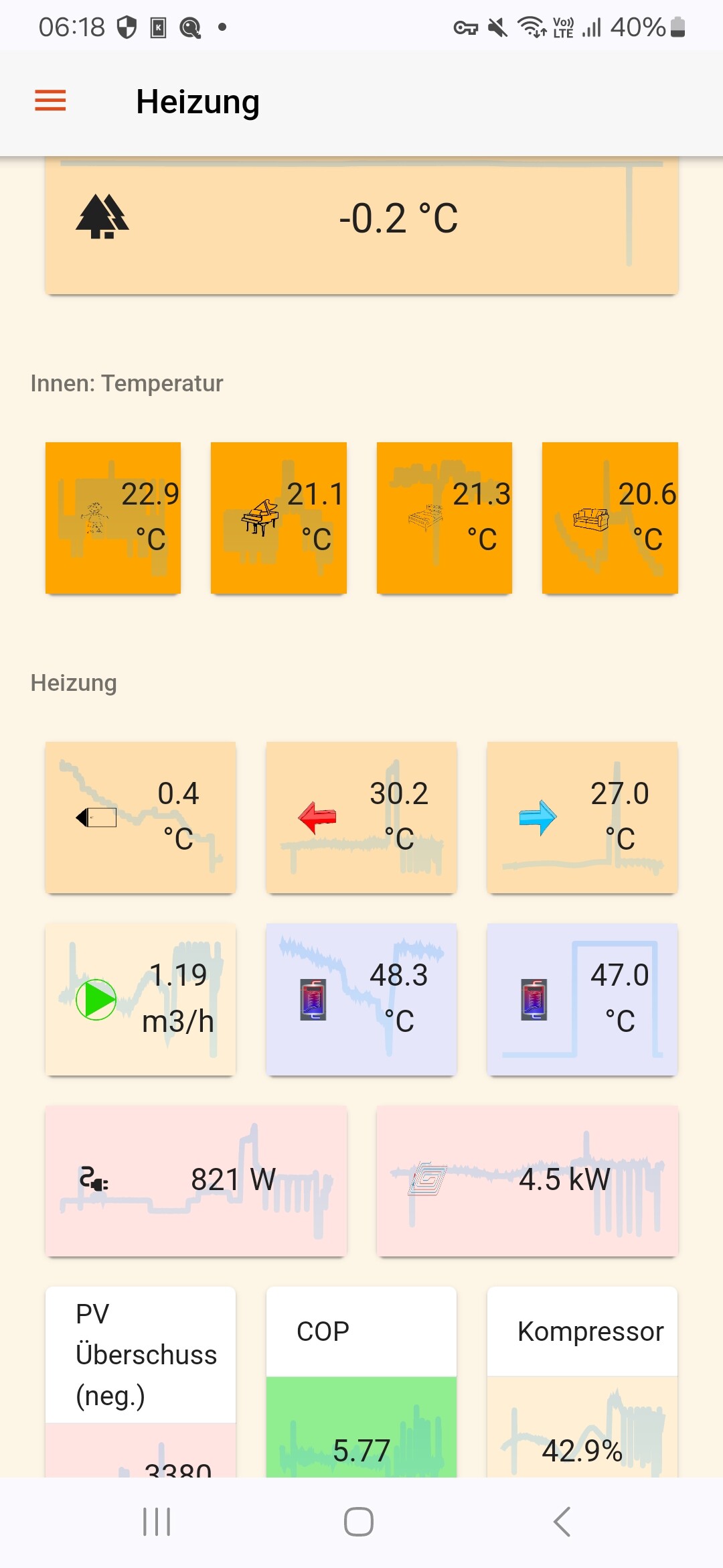

As you can see, on a phone screen there is even not enough space to show temperatures in a 4 column layout anymore:
although there would be enough space (in my opinion), just with smaller margins.

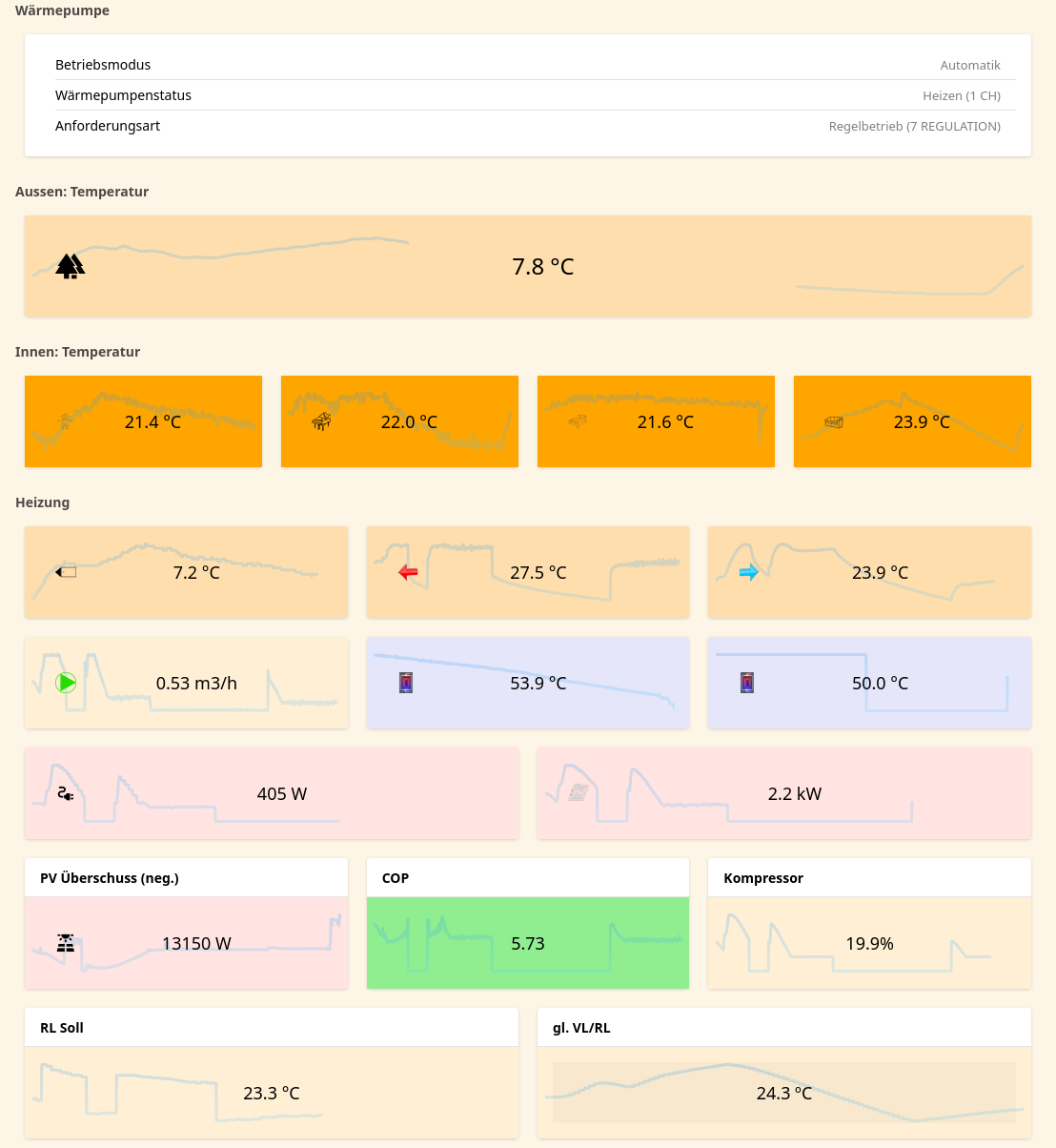

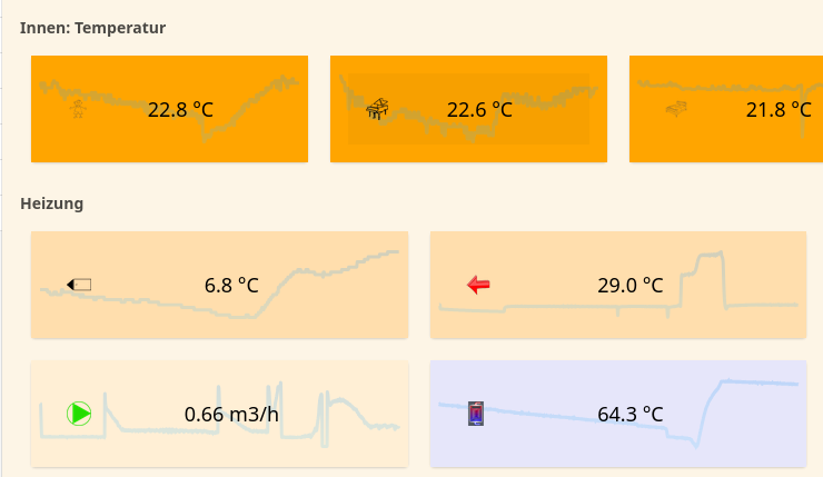

Same page in Firefox on a computer monitor:
Looks “ok”, but it needs the whole page.
As requested, here the YAML for this page:
  label: Heizung
  order: "5"
  sidebar: true
  style:
    background: oldlace
blocks:
  - component: oh-block
      title: Wärmepumpe
      default:
        - component: oh-grid-row
          config: {}
            default:
              - component: oh-grid-col
                config: {}
                  default:
                    - component: oh-list-card
                      config: {}
                        default:
                          - component: oh-label-item
                              item: Warmepumpe_General_Ambient_Operating_State_Value
                              subtitle: GenAmb. Op. State
                              title: Betriebsmodus
                              item: Warmepumpe_Operating_State_Value
                              subtitle: Hp Op. State
                              title: Wärmepumpenstatus
                              item: Warmepumpe_Heatpump_Hp_State_Value2
                              subtitle: Hp State
                              title: Anforderungsart
      title: "Aussen: Temperatur"
      default:
          config: {}
            default:
                config: {}
                  default:
                    - component: oh-label-card
                        action: analyzer
                        actionAnalyzerItems:
                          - WP_ActualAmbientTemperature_Value
                        background: navajowhite
                        icon: material:forest
                        item: WP_ActualAmbientTemperature_Value
                        trendItem: WP_ActualAmbientTemperature_Value
                        trendSampling: 1
      title: "Innen: Temperatur"
      default:
          config: {}
            default:
                config: {}
                  default:
                        action: analyzer
                          - Shelly_HT_3__Temperature
                          - Shelly_HT_1__Temperature
                          - Shelly_HT_2__Temperature
                          - WetterstationInnen_Indoor_Temperature
                        background: orange
                        fontSize: 18px
                        icon: kind.png
                        iconSize: 20
                        item: Shelly_HT_3__Temperature
                        trendItem: Shelly_HT_3__Temperature
                        trendSampling: 1
                config: {}
                  default:
                        action: analyzer
                        background: orange
                        fontSize: 18px
                        icon: piano.png
                        iconSize: 20
                        item: Shelly_HT_1__Temperature
                        trendItem: Shelly_HT_1__Temperature
                        trendSampling: 2
                config: {}
                  default:
                        action: analyzer
                        actionAnalyzerItmes:
                        background: orange
                        fontSize: 18px
                        icon: bed.png
                        iconSize: 20
                        item: Shelly_HT_2__Temperature
                        trendItem: Shelly_HT_2__Temperature
                        trendSampling: 4
                config: {}
                  default:
                        action: analyzer
                        background: orange
                        fontSize: 18px
                        icon: sofa.png
                        iconSize: 20
                        item: WetterstationInnen_Indoor_Temperature
                        trendItem: WetterstationInnen_Indoor_Temperature
                        trendSampling: 1
      title: Heizung
      default:
          config: {}
            default:
                config: {}
                  default:
                        action: analyzer
                          - Warmepumpe_Calculated_Ambient_Temperature_Value
                        fontSize: 18px
                        icon: wp_at.png
                        iconSize: 22
                        item: Warmepumpe_Calculated_Ambient_Temperature_Value
                        trendItem: Warmepumpe_Calculated_Ambient_Temperature_Value
                        trendSampling: 1
                config: {}
                  default:
                        action: analyzer
                        actionAnalyzerCoordSystem: time
                          - WP_Tflow_Value
                          - WP_Treturn_Value
                        fontSize: 18px
                        icon: pfeil_rot_links.png
                        iconSize: 22
                        item: WP_Tflow_Value
                        trendItem: WP_Tflow_Value
                        trendSampling: 1
                config: {}
                  default:
                        action: analyzer
                          - WP_Tflow_Value
                          - WP_Treturn_Value
                        fontSize: 18px
                        icon: pfeil_blau_rechts.png
                        iconSize: 22
                        item: WP_Treturn_Value
                        trendItem: WP_Treturn_Value
                        trendSampling: 1
          config: {}
            default:
                config: {}
                  default:
                        action: analyzer
                          - WP_Treturn_Value
                          - WP_Tflow_Value
                          - Warmepumpe_Heatpump_Vol_sink_Value
                        background: papayawhip
                        fontSize: 18px
                        icon: wp_hlp.png
                        iconSize: 22
                        item: Warmepumpe_Heatpump_Vol_sink_Value
                        trendItem: Warmepumpe_Heatpump_Vol_sink_Value
                        trendSampling: 1
                config: {}
                  default:
                        action: analyzer
                          - WP_Actual_High_Temperature_Value
                        background: lavender
                        fontSize: 18px
                        icon: wp_boiler.png
                        iconSize: 22
                        item: WP_Actual_High_Temperature_Value
                        trendItem: WP_Actual_High_Temperature_Value
                        trendSampling: 1
                config: {}
                  default:
                        action: analyzer
                          - Warmepumpe_Boiler_SetMaximumBoilerTemperature_Value
                          - Stromzaehler_Haus_Leistung_Total
                        fontSize: 18px
                        icon: wp_boiler.png
                        iconSize: 22
                        item: Warmepumpe_Boiler_SetMaximumBoilerTemperature_Value
                        trendItem: Warmepumpe_Boiler_SetMaximumBoilerTemperature_Value
                        trendSampling: 1
          config: {}
            default:
                config: {}
                  default:
                        action: analyzer
                          - WP_ActualPowerConsumption_Value
                          - Warmepumpe_Heatpump_Qp_Value
                        background: mistyrose
                        fontSize: 18px
                        icon: "material: electrical_services"
                        iconSize: 22
                        item: WP_ActualPowerConsumption_Value
                        trendItem: WP_ActualPowerConsumption_Value
                        trendSampling: 1
                config: {}
                  default:
                        action: analyzer
                        fontSize: 18px
                        icon: fbh.png
                        iconSize: 22
                        item: Warmepumpe_Heatpump_Qp_Value
                        trendItem: Warmepumpe_Heatpump_Qp_Value
                        trendSampling: 1
          config: {}
            default:
                config: {}
                  default:
                        action: analyzer
                          - Warmepumpe_General_EManager_Actual_Power_Excess_Value
                        fontSize: 18px
                        icon: "material: solar_power"
                        iconSize: 22
                        item: Warmepumpe_General_EManager_Actual_Power_Excess_Value
                        title: PV Überschuss (neg.)
                        trendItem: Warmepumpe_General_EManager_Actual_Power_Excess_Value
                        trendSampling: 1
                config: {}
                  default:
                        action: analyzer
                          - WP_COP_Value
                        background: lightgreen
                        fontSize: 18px
                        iconSize: 22
                        item: WP_COP_Value
                        title: COP
                        trendItem: WP_COP_Value
                        trendSampling: 1
                config: {}
                  default:
                        action: analyzer
                          - Warmepumpe_Kompressorrating_Value
                        fontSize: 18px
                        iconSize: 22
                        item: Warmepumpe_Kompressorrating_Value
                        title: Kompressor
                        trendItem: Warmepumpe_Kompressorrating_Value
                        trendSampling: 1
          config: {}
            default:
                config: {}
                  default:
                        action: analyzer
                          - WP_Treturn_Value
                          - calc_RL_Soll
                        fontSize: 18px
                        iconSize: 22
                        item: calc_RL_Soll
                        title: RL Soll
                        trendItem: calc_RL_Soll
                        trendSampling: 1
                config: {}
                  default:
                        action: analyzer
                          - WP_Treturn_Value
                          - WP_Tflow_Value
                          - Warmepumpe_VL_RL_Avg
                        fontSize: 18px
                        item: Warmepumpe_VL_RL_Avg
                        title: gl. VL/RL
                        trendItem: Warmepumpe_VL_RL_Avg
                        trendSampling: 1
masonry: []
grid: []
canvas: []
… yes, I set fontSize and iconSize manually… But I have other pages without these manual overrides, and they show the same problems - everything is much bolder, needs much more space, and especially on a phone screen space is limited.
Ah, just found a screenshot from this page from last November on my phone :wink:
And now (as above):
Quite impressive difference.
