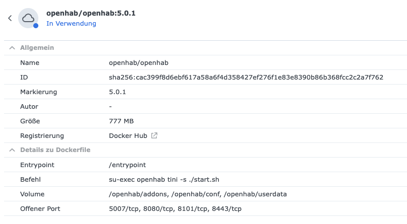

If you are using the Synology-Containermanager it is possible to “duplicate” the container and edit the entrypoint manually to su-exec openhab tini -s ./start.sh

Luckily, @uk59821’s workaround worked for me: I duplicated the container and then manually patched the entrypoint. I have the same folder mapping as you do.

The the bash script that I use to create the container follows. The container it creates has the Execution command = su-exec openhab tini -s ./start.sh.

I had the same issue and resolved it by exporting the container settings, editing the entry point, and creating a new container. Pro tip: delete the old container before creating the new one to avoid port conflicts.
Yes thanks, that actually seems to work!
