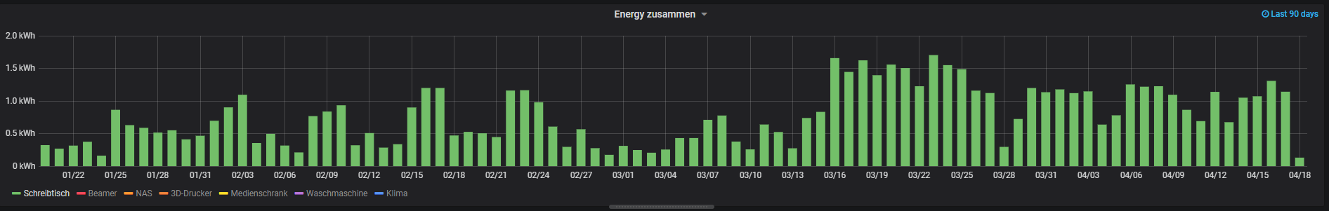

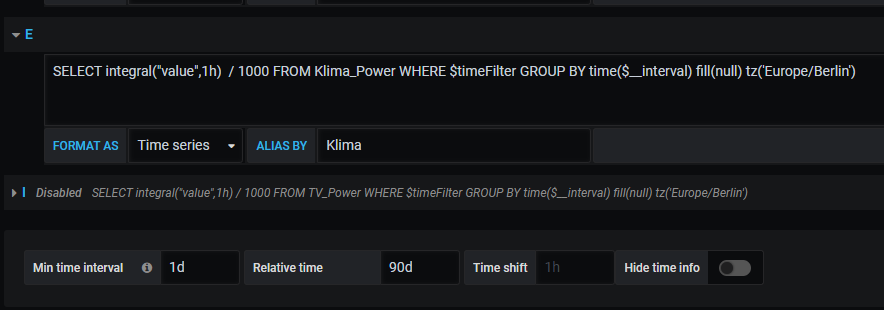

Also it would be cool, if one could enable “auto-tagging” based on the current timestamp. Means: putting a tag for the current month, year and maybe week number. Since otherwise it’s almost impossible to perform grouping with influxdb in Grafana. E.g. to graph the power consumption sum on a week, month or year basis.

That could be a starter, thanks! I was just reading about that there’s currently no way to group by month or year - only per days. So it’s always about the last n days and not about concrete and exact months. E.g. “show me the sum of consumption of january” (exactly 01.01.-31.01.) would be easier then to create graphs showing the totals over a year per month.
while you wait for OH 3.0, you can directly send data to InfluxDB from OH instead of using persistence which allows you to put in any tags you want. Or course you can’t retrieve them from persistence then either, but if you normally look at the data through Grafana, this can work. Example here.
