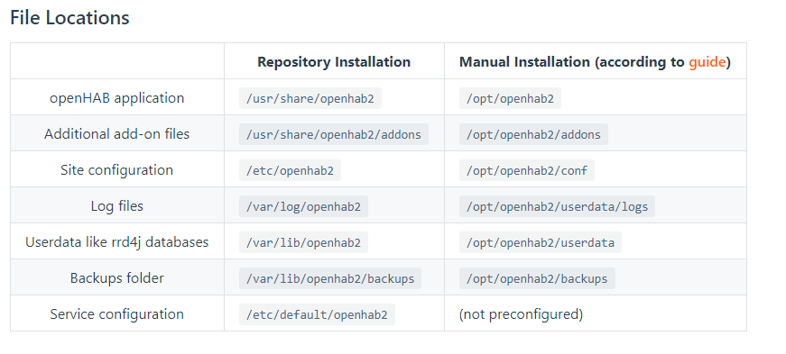

No. We do not play guessing games here.
You have not provided enough information about your type of installation to determine file locations.
from openHAB on Linux | openHAB

as mentioned, there is log since the update in
/var/log/openhab2/openhab.log
/var/log/openhab2/events.log
