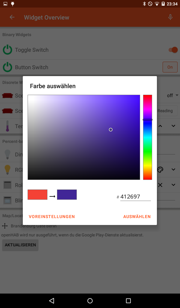

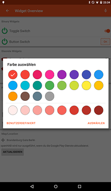

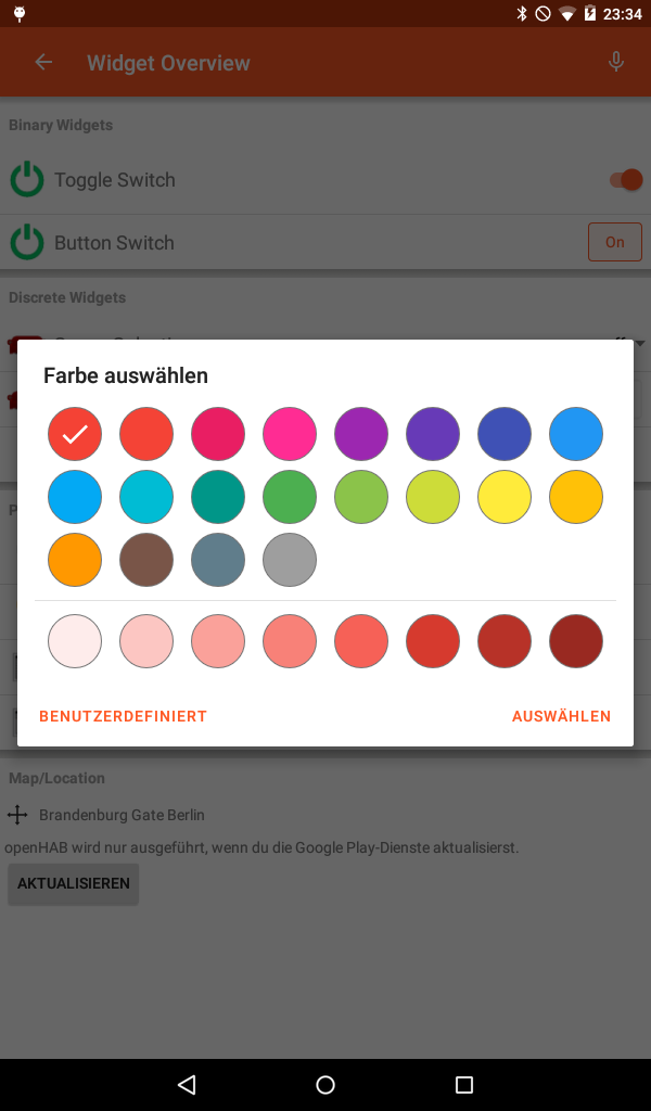

In a testing branch I replaced the old color picker by a new one. It has two modes: Presets and Custom. The user can switch between them, but “Presets” is always the default.
What do you think about this?

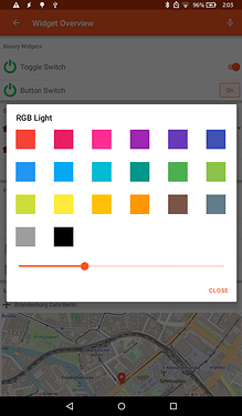

Screenshot_20200208-220643
While I understand the concept of HSV and thus the meaning of the two sliders in the current picker, it doesn’t feel intuitive. If I want to change from blue to warm white, I have to select yellow/orange and change the upper slider. And why is the lower slider 100% - 0% brightness and not the other way round.
I can think of a good compromise: Like the color picker in the first post, but my color picker as the preset one (a few white tones need to be added) and the old color picker as the custom one. And the picker remembers the last state (custom or preset).

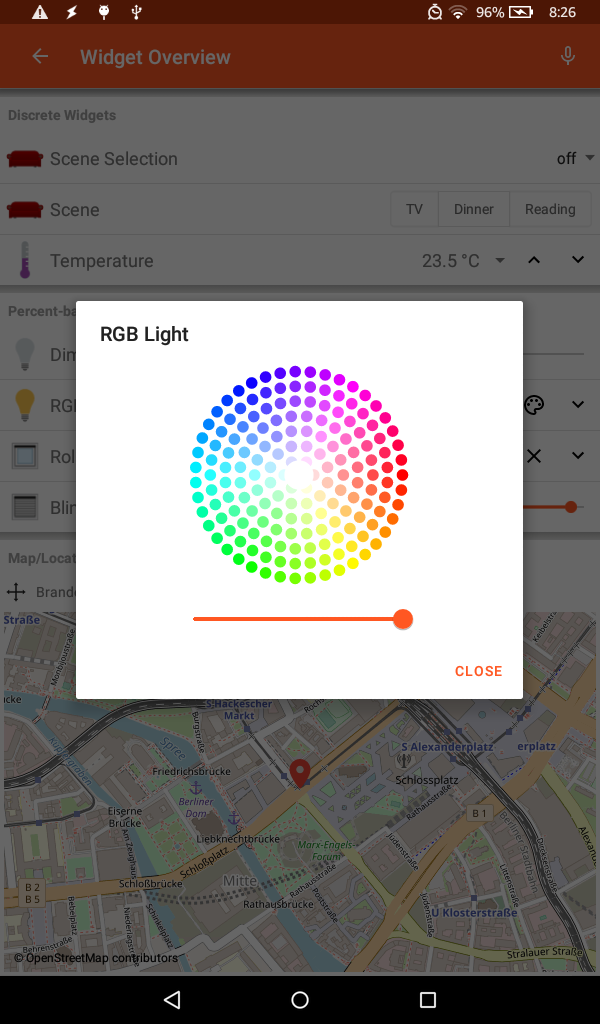

I’ll give it a try. Probably with a custom dialog, so we can use the material slider for brightness.

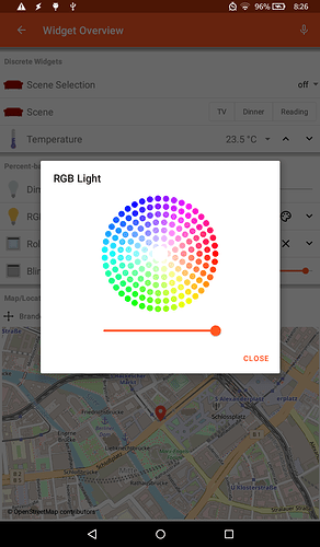

Which version do you prefer more?
Screenshot_1582797065 Screenshot_1582797223
+1 from me for the version with less dots.
+1 from me for the version with more dots :wink:

Can you share the code for the simple colour picker in your first screenshot. I’m really loving it. A simple approach!
Hey @fi8er1,
the color picker in the first two screenshots is GitHub - jaredrummler/ColorPicker: A highly customizable color picker for Android.
