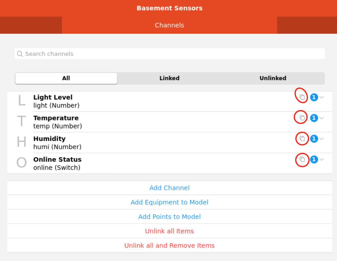

  • If you are using MainUI to create the Links to the Items, or using “Add Equipment to Model” or “Add Points to Model” you never have to care about the actual Channel IDs. That’s handled for you.
  • The Channel in the UI has a little copy icon. Click that and it will copy the Channel ID to the clipboard.
  • Clicking on the Channel and then on “Configure Channel”
But again, if you are managing your Items in the UI, you don’t care. You will never have to actually see or use these Channel IDs.

BTW, I get no copy icons…

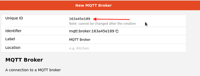

Once the Thing is created then yes, you cannot change it. But when you first create the Thing you have the option to set the ID to some degree. However, a Thing ID is a combination of the Broker Thing’s ID, the Generic Thing’s ID, and the Channel ID. So if you need to match the IDs you had before you’d have to recreate everything. But this time instead of using what ever gets randomly put in you should supply the ID that matches your old one.

It’s probably a new feature in OH 3.1 which I believe is being released at the end of next week.

For the Things names, the UI adds a UID to the ID, before anything I enter, so the new name can’t match the old names…unless I’m missing something, which s probably the case.

You can change all the things with the red arrow prior to clicking “Create Thing”.
