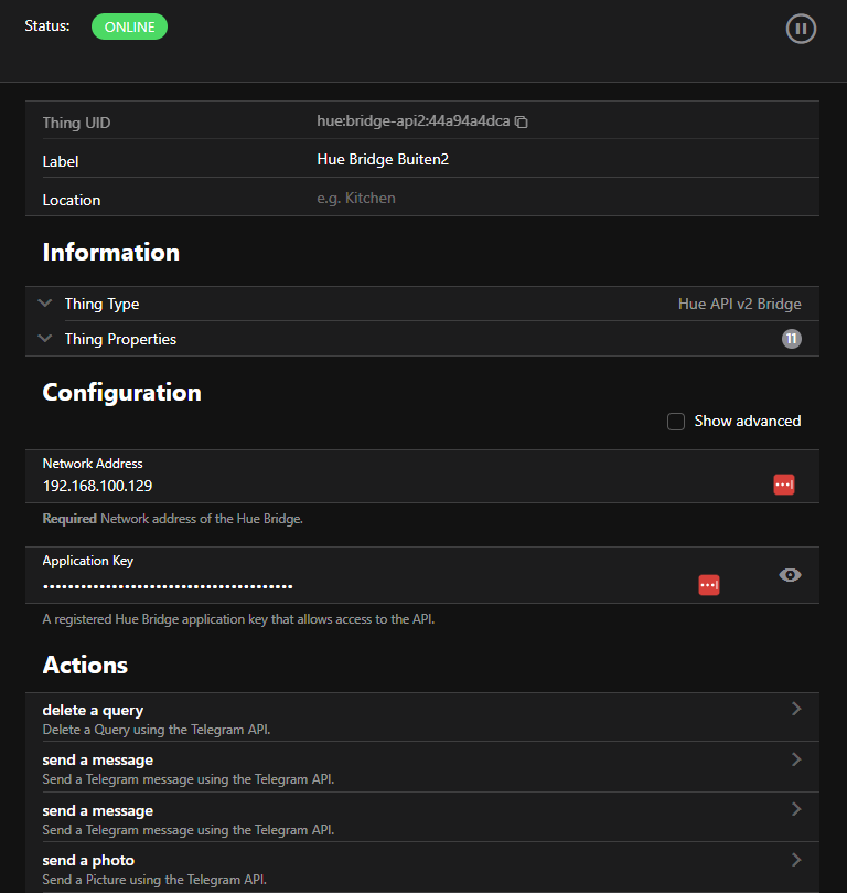

Something to add. I deleted the Telegram thing (is only one) and created it again and came online. Maybe this helps.
That usually means the binding is not installed.
Because you are file based, it might be something changed for the add-ons that are not working that you need to change in your .things files to adjust for breaking changes in those add-ons.
Note, based on your logs you have at least five Links defined through the UI in addition to your .items files.
