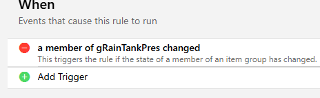

With the “When” showing:
instead of the following (copied from Production system):

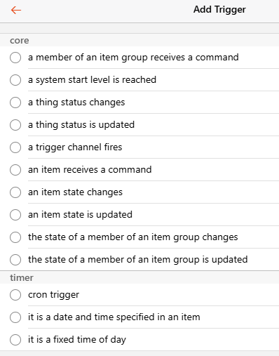

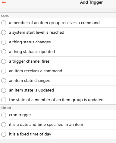

When I try to add the trigger back the option “group has changed” trigger is no longer present on the Dev system, OH 5.0.3
Whereas on the Production system running 5.0.2 it is present:

Same issue when creating new rule. The options available do not include “the state of a member of an item group changes”.
