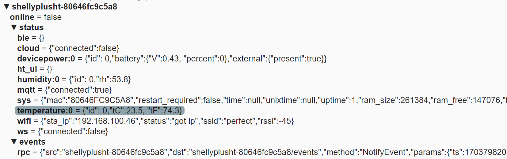

The Shelly binding is not working for H&T devices anymore. As far I can read this is not solved yet. Because my room temperature is based on this sensor I try to create a workaround based on MQTT.
At the moment I can read with MQTT explorer the values
So far so good.
