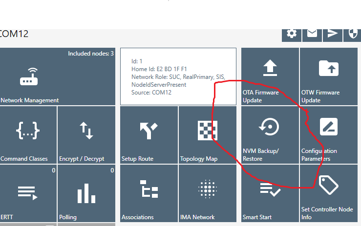

You mentioned about free simplicity studio. I have this installed (free version). Do you know how to do this with this tool?
It is the NVM backup option; Again read or write
many thanks. Let me try. I shall come back with some feedback soon

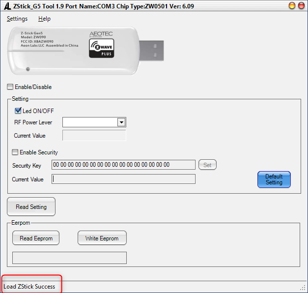

For my update I used ZStick G5 Tool from aeotec. I made a try and opened it with UZB stick. And it tells me Load ZStick Succes.
I am just wondering if I shall give a try to update it with the imige from aeotec. I do not want to flash sth. what may damage the device :face_with_monocle:

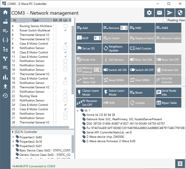

  1. I had some ghost nodes in my old aeotec controller so i decided to remove them with the Z-Wave PC controller. I was able to do this withour problems.
  2. I connected the UZB to the new OH3 system. It has been recognised and slowly my devices appearing as thing in the system. At the moment I see only 7 out of 30 but assume with the time they will appear…

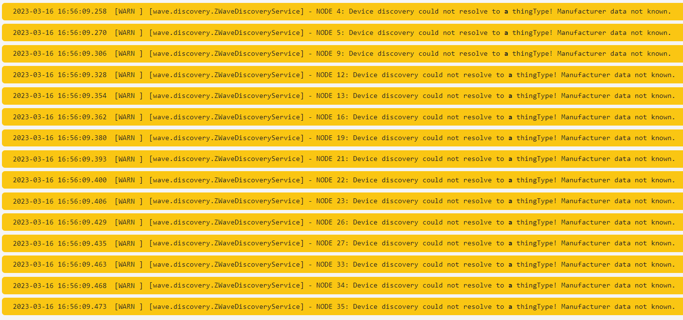

All nodes have been found but many of then not fully and are not showing all of the configuration parameters. Any idea how to solve it? Heal device? Remove and add again? What is the right procedure for that?
From what I can see from your picture, all the devices with a warning are non listening. I would wake them. Heal, remove,etc will not help.
Edit: if that doesn’t do it (it likely will). Compare your 2.5.12 zwave folder content with the 3.4.2 zwave folder contents and copy only the missing files over (the ones that are there already should be the ones that are working okay). Then restart the zwave binding in Karaf bundle:restart … or just restart OH3
