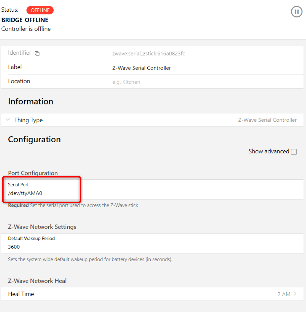

I use AEOTEC USB Z-wave stick 5Gen and it is not being recognised by the OH3 on RPi 4. I read this post and find out there are problems with the compatibility
it is not even recognised after connecting to the usb slot so i assume it needs to be connected over the hub. I do not want to go this way. It means I have to migrate with every singe z-wave node to the new system.

Not an expert, but I have always seen the aeotec come up as ttyACM0 on both Rpi3 and Rpi4. Usually ttyAMA0 means there is a problem. Should be a quick try. Just change the port and wait 30 seconds. If not, then it is something else.
