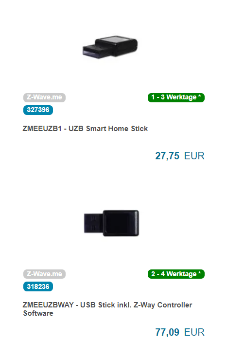

I just found these:
Distance is never an issue as the zwave network will build a mesh network with all mains powered devices.
You just have to buy enough mains powered devices and place them accordingly.
As already said before: openHAB does not support 700 series controllers
If you want to use the z-way binding, you will need a license which is included in the expensive uzb controller.
If you want to use the zwave binding, you can stick to the cheaper one.
