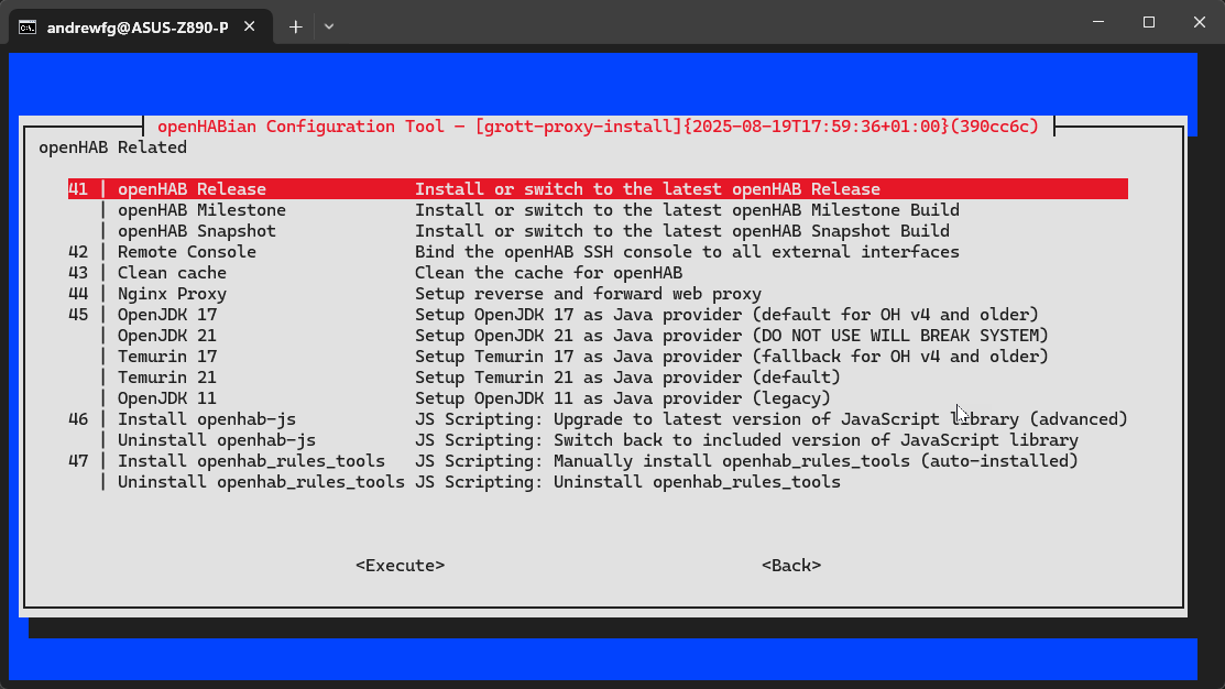

  • Menu 45 allows to select the Java version
  • Menu 41 allows to select the OH version
openHABian will install the default, Temurin 21. If you want a different JRE for what ever reason, would use Menu 45.
When you change the version of OH to install (though Menu 41)(openhabian/functions/menu.bash at 40e088cf306b17038a6184796868cbbfa34e2097 · openhab/openhabian · GitHub), it executes this function. You can see here that if the version of OH is 5, it changes the default jre and installs Temeruin21 if it’s not already installed automatically as part of changing the version of OH.
The full code is posted below so you don’t have to jump around multiple files.
Menu 41:
    case "$choice2" in
      41\ *) openhab_setup "release";;
      *openHAB\ Milestone) openhab_setup "milestone";;
      *openHAB\ Snapshot) openhab_setup "snapshot";;
      42\ *) openhab_shell_interfaces;;
      43\ *) openhab_clean_cache;;
      44\ *) nginx_setup;;
      *OpenJDK\ 17) update_config_java "17" && java_install "17";;
      *OpenJDK\ 21) update_config_java "21" && java_install "21";;
      *Temurin\ 17) update_config_java "Temurin17" && java_install "Temurin17";;
      *Temurin\ 21) update_config_java "Temurin21" && java_install "Temurin21";;
      *OpenJDK\ 11) update_config_java "11" && java_install "11";;
      46\ *) jsscripting_npm_install "openhab";;
      *Uninstall\ openhab-js) jsscripting_npm_install "openhab" "uninstall";;
      47\ *) jsscripting_npm_install "openhab_rules_tools";;
      *Uninstall\ openhab_rules_tools) jsscripting_npm_install "openhab_rules_tools" "uninstall";;
      "") return 0 ;;
      *) whiptail --msgbox "An unsupported option was selected (probably a programming error):\\n  \"$choice2\"" 8 80 ;;
    esac

That’s in openhab_setup() which is what’s called by Menu 41 and it does the following steps:
  1. configures the repo based on what was chosen between snapshot, release, or milestone.
  2. does a work around with the clock to ensure the signing key works
  3. if the machine is online (i.e. can reach the internet)
    a. configure the repo key
    b. runs apt clean and apt update
    c. collect the latest openHAB version in the repo and the installed java version
    d. if the latest version of OH available is 5 and the java version is less than 21 install Temurin21
  4. check to see if Java 21 is installed if the latest version of OH is 5 and error if it’s not.
  5. finally install the latest OH in the selected repo
  6. change file ownership and do some final config steps (e.g. zram redirects)
It was awhile since I looked at this code which is why I said “I think” above. But it is definite. You do not need to upgrade to Java 21 manually or as a separate step when using openHABian. Upgrading OH using menu 41 will upgrade Java automatically for you.
