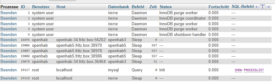

I’ve recently upgraded from OH 3.4 to OH 5.1. Erverything works fine. Thanks for the smooth upgrade procedure. Unfortunately the OH 5.1 does not write any data to my MariaDB database. The only thing I’ve changed after the upgrade is the target DB. I could see in the DB status tab, that the user “openhab” is logged in successfully to the database “openhab5”:

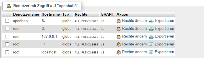

The user rights are the same as for the “openhab3” database:

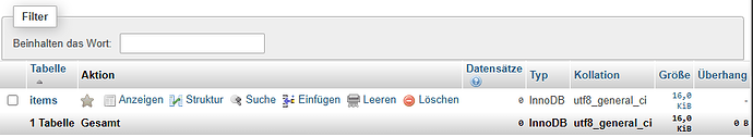

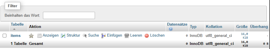

But no item data is stored. But the “items” table was create successfully:

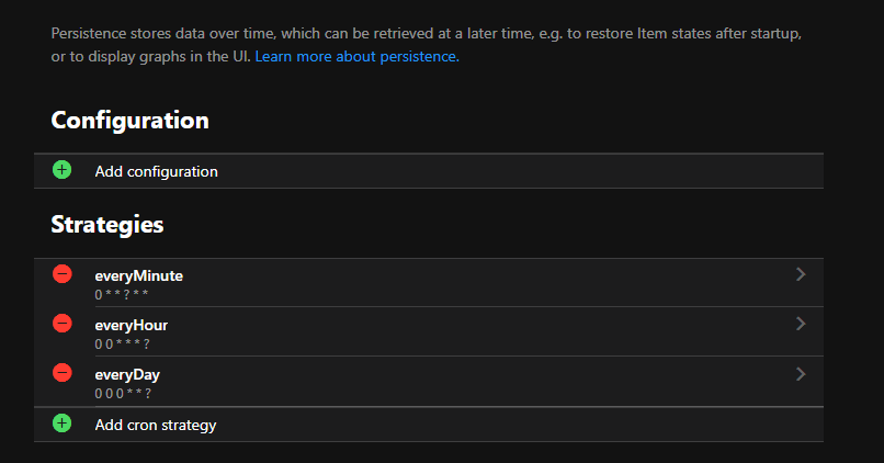

And these are the persistence policies:

Defining the strategies doesn’t actually do anything. You have to actually apply those strategies to the Items you want to have saved using those strategies. For that you need to add one or more configuration where you select the Items (or all Items) and choose the strategy to apply.
Right now you’ve no configurations, so persistence is not going to save anything. In OH 5.1 the default configuration no longer exists (i.e. save every state update of every Item and do restoreOnStartup). You have to define that yourself now.
