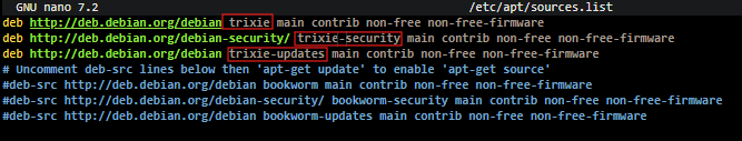

2. Edit sources.list for Debian Trixie
Change all references from bookworm to trixie in:
/etc/apt/sources.list
Also update any files in:
/etc/apt/sources.list.d/
For example, I updated the raspi.list file

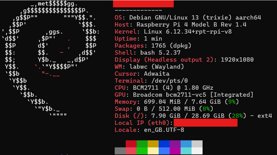

[OPTIONAL] Install fastfetch and Verify
Debian 13 includes fastfetch, a modern and faster alternative to neofetch.
Install it with:
sudo apt install fastfetch
Final Thoughts
While Bookworm is EOL in 2028, Trixie is currently the only distro that comes with openjdk-21-jdk (21.0.8+9-1). This upgrade went smoothly on my end.
Please do let me know if anyone experiences issues upgrading from Debian 12 to 13.
