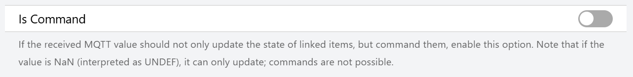

The reason for this is, that the switch “Is Command” in your MQTT channel configuration needs to be OFF (except you want to command the state of a linked item based on the received MQTT value). What you describe happens if this switch is ON, right?
If you have many MQTT channels, you probably need to go through all of them to check for this switch.
Thank you for the pointer, here were indeed a couple of mqtt channels where this was enabled - now disabled. Will test upgrading again to check if it is fixed.
I can confirm that the “Is command” mqtt setting caused the problem. Openhab seems to be running fine after reinstalling openhab 5.2.1, then restoring the 4.3.10 backup.
