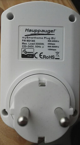

I also have problems with PAN11 … what are yours?
I can switch them … but no other stuff like “power consumption” etc is working.
In my case they are not even switchable. Have not tested any other channel then the binary switch.
When swiping on/off the following error is given in the log:
Generating message failed for command class = SWITCH_BINARY, endpoint = 0

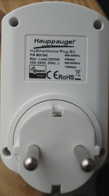

:fearful: ok I don’t understand why my only can be switched but show no values at all… :frowning:
any config parameters or associations you changed for the plug?
I actually tried anything but find no solution that it shows values - I have 4 of these … and they all show nothing
hey @chris since now the PAN11 work for @sirwio do you think maybe the “Hauppauge” labeled ones should actually be NOT recognized as PAN11 by discovery?
I’m not sure - I don’t know what your thinking is here, but often we find that a device is made by one company, but sold as a different one, and it still has the original manufacturers information in the discovery data. So, it all comes down to the identifiers in the device as to how it will be discovered.
