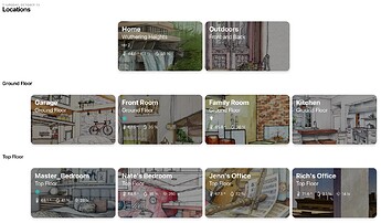

All the images you see here used as the background of the locations cards come from the $OH_CONF folder and are configured using /static/imagename.png/
