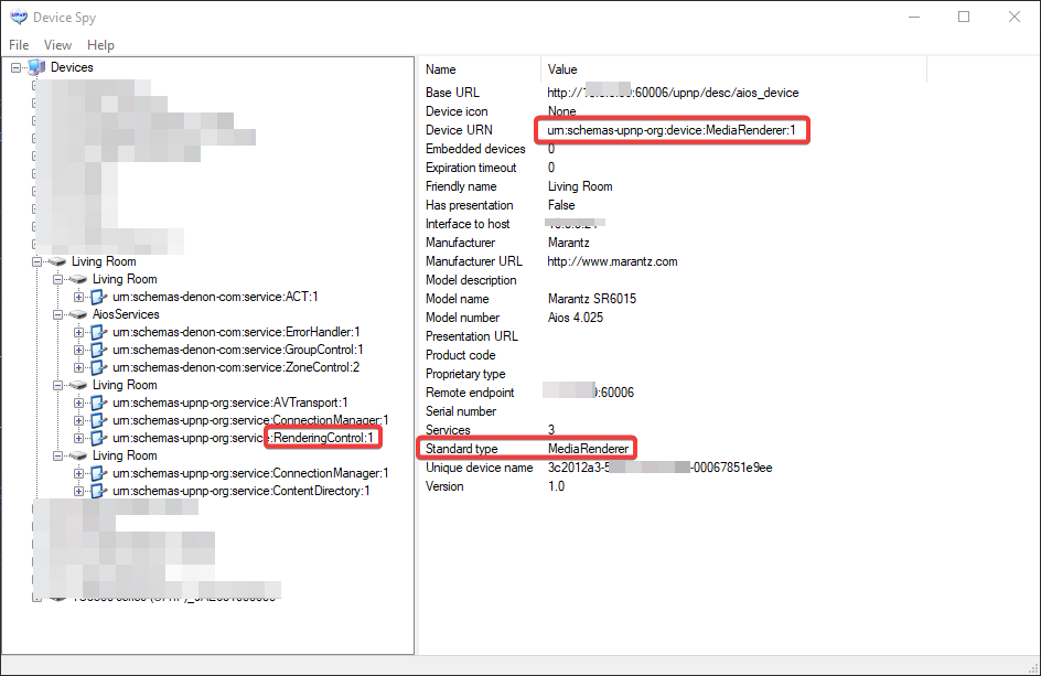

In fact my SR6015 plays music smoothly from bubbleupnp on my Android Phone. Also the Intel UPnP Tools as linked by the UPnP Control Binding detect my device as renderer:

Nowadays many manufacturer use afaik UPnP/DLNA with additions for their own purposes. AFAIK Sonos also an enhanced UPnP Protocol for their speakers. Also my router, tv and printer use it.
I assume, that there could be a couse of this problem. Probably the discovery of upnp-near bindings affects the discovery of “native” upnpcontrol things.
