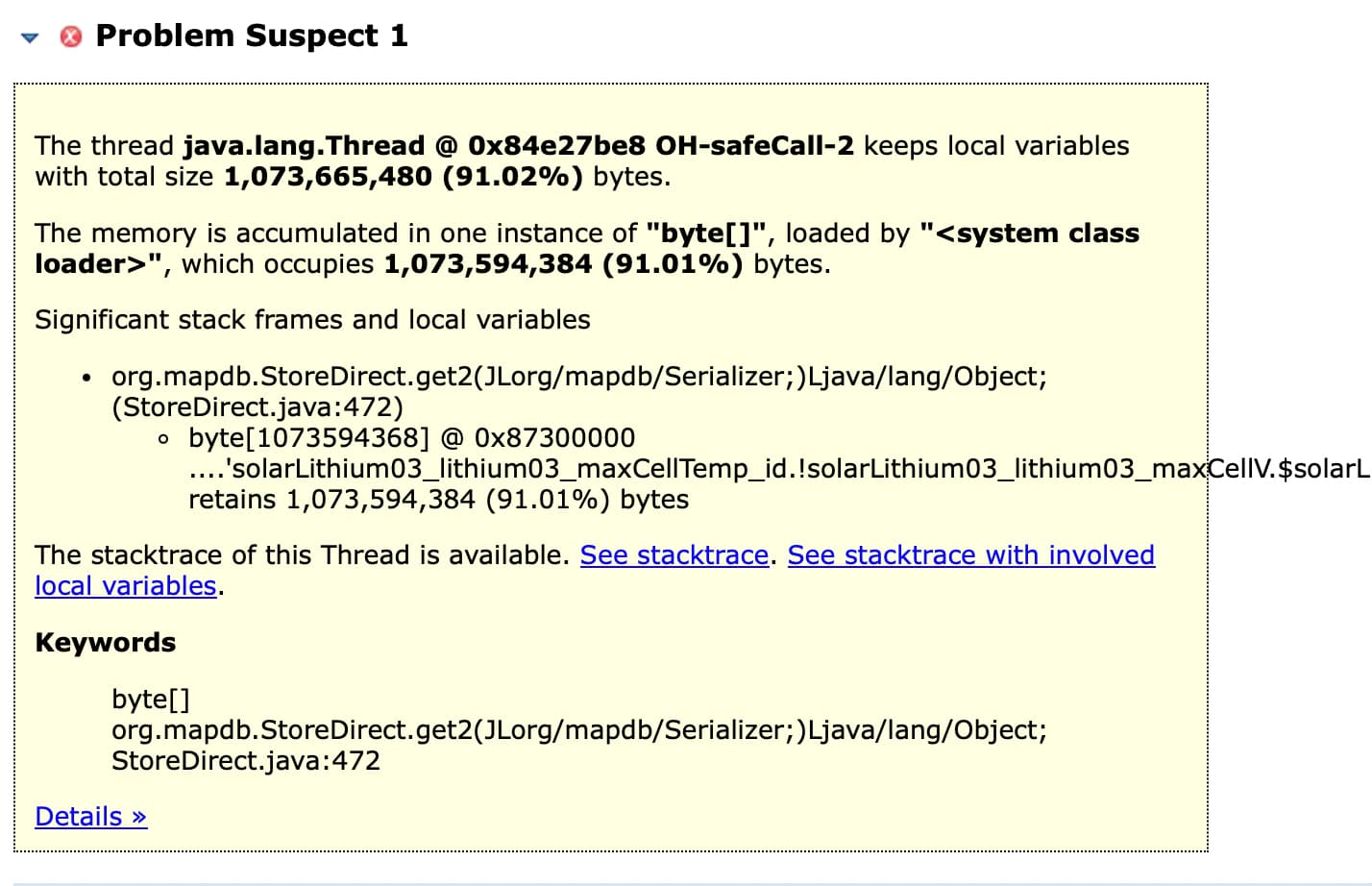

Hello all so I have the Report From Eclipse MAT
Not sure I understand 100% but
Seems that “mapdb” is a problem for the objects i collect from my Lithium Iron Batteries - Not sure why though -
I would not have thought mapdb would cause this because it should onl;y hold the last value
Can I tell openHAB to start without persistence if this is the issue
I have a 5 day old backup (so not minor but recoverable changes and discoveries and I have the last json db backups to troll trough for pointers on changes needed.)
Could i Move the whole of mapdb files/folder/directory somewhere else and restart openHAB?
Mapdb files do not see overly big but they are mixed text and binary (using cat) so not sure what they should look like

@wborn thanks for your guidance. I was able to discover the mapdb was corrupt and deleted it and restarted the system . I will put a small outline/report here tomorrow for others future reference but for now its closed - thanks
Happy to hear that! Without inspecting an actual heap dump, it’s like trying to solve a jigsaw puzzle blindfolded. :upside_down_face:
