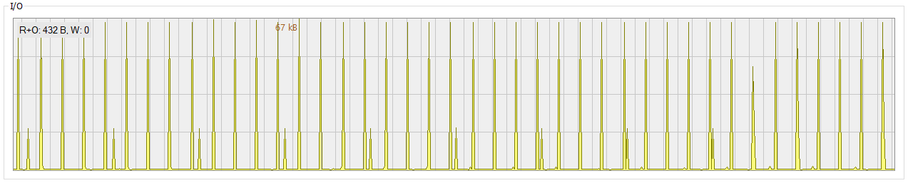

What this shows me, it that most likely, WindowsUsbSerialDiscovery processes some ~65 KB every 15 seconds just to poll for USB devices. So, I’m looking at a different way to do this.

I don’t think it’s reasonable that the “USB detection feature” has this much of an impact on a running OH instance, especially considering that no actual change to USB devices happened during the sampling (so no actual action took place):
(the peaks every 15th second are the “USB detections”, the other, lower peaks are other tasks)
