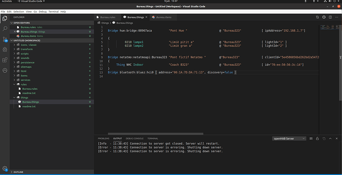

  5. I created a bridge in my .things file

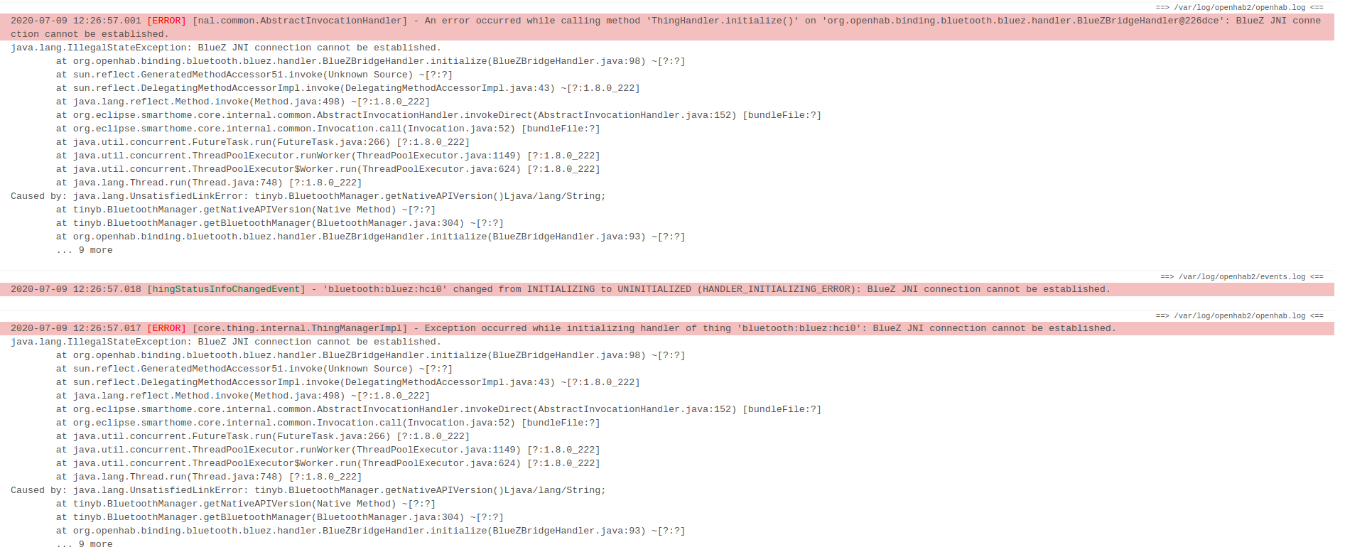

  6. But I get this erreur
  7. I try to use this method but it does not solves my erreur
    [SOLVED] Error when Adding Bluetooth BlueZ Adapter: "BlueZ JNI connection cannot be established." - #2 by Kevin71246
Someone has another idea?
What version of Bluez ?
Please note that at least BlueZ 5.43 is required, while 5.48 or above are not (yet) supported either.
I install the version 5.47
