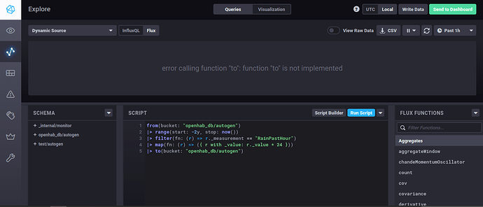

Trying to run the following Flux-code in Chronograf (which should theoretically do what I wanted to do)…
from(bucket: "openhab_db/autogen")
|> range(start: -2y, stop: now())
|> filter(fn: (r) => r._measurement == "RainPastHour")
|> map(fn: (r) => ({ r with _value: r._value * 24 }))
|> to(bucket: "openhab_db/autogen")
… just led to a nice error saying error calling function "to": function "to" is not implemented.
So doing the data change via this approach would require influxDB 2.x. Unfortunatlely influxDB 2.x requires a 64 Bit OS, which I learned is something that’d require me to re-set up my entire system from scratch. Plus, although upgrading from influxDB 1.8 to 2.0 looks doable, it would be a bit over the top just to change a bunch of values. So back at square 1.

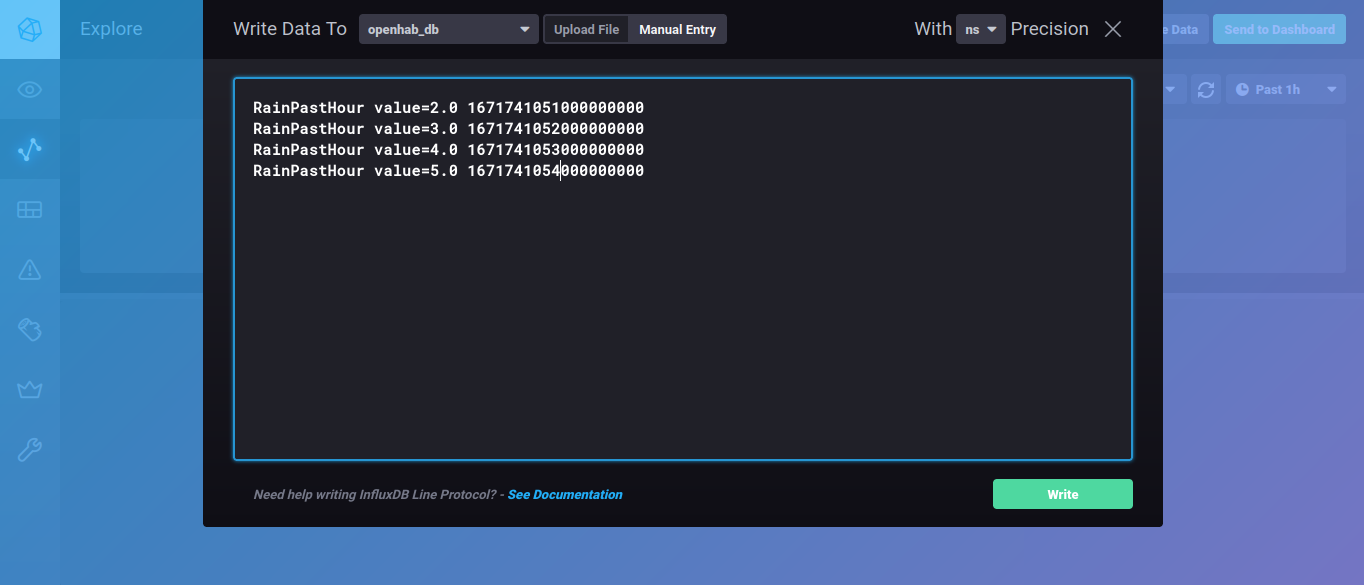

#4 Use the “write data” function in Chronograf
This one is actually pretty neat. In Chronograf, if you click on Explore and then Write data, a window opens that expects the same command as the terminal-box, except that you don’t need insert (e.g. <item name> value=2.0 1638301257000000000). Plus, it allows you insert more strings below each other, which is really handy if you want to include more values at once:
Press Write and you’re done.

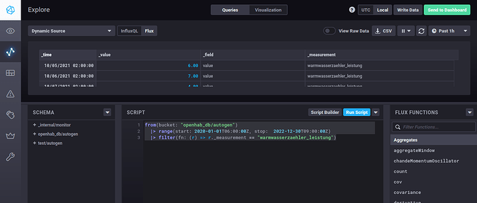

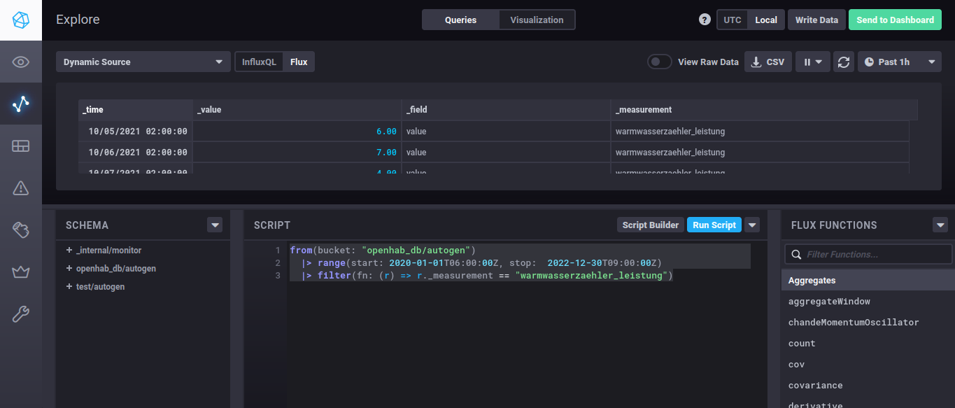

- Extract all data that you want to manipulate into a .csv by adjusting the following Flux code to your needs…
|> range(start: 2020-01-01T06:00:00Z, stop: 2022-12-30T09:00:00Z)
|> filter(fn: (r) => r._measurement == "warmwasserzaehler_leistung")
… run it and download the result as .csv.
