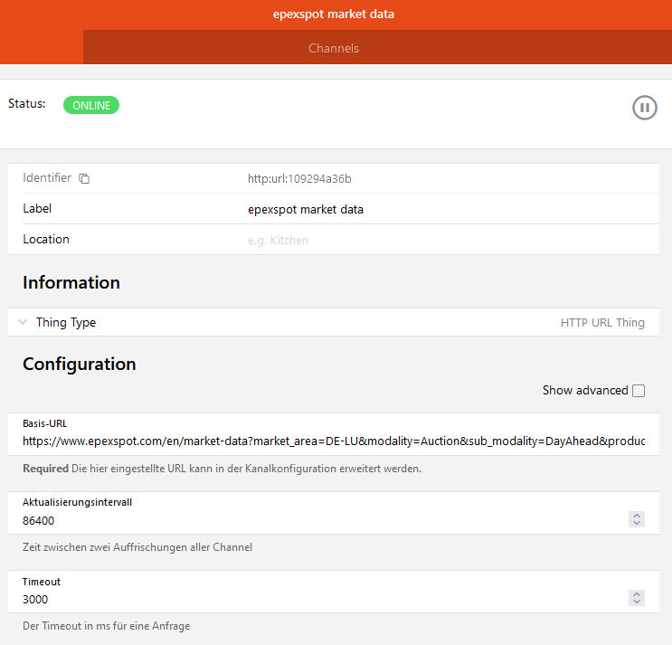

Things → Add → HTTP Binding → HTTP URL Thing
Base URL:
https://www.epexspot.com/en/market-data?market_area=DE-LU&modality=Auction&sub_modality=DayAhead&product=60&data_mode=table
Replace DE-LU with your power market area:
Do not create the Thing before 1 pm and do not change the update interval (86400 s = 1 day).
UID: http:url:109294a36b
label: epexspot market data
thingTypeUID: http:url
configuration:
  authMode: BASIC
  ignoreSSLErrors: false
  baseURL: https://www.epexspot.com/en/market-data?market_area=DE-LU&modality=Auction&sub_modality=DayAhead&product=60&data_mode=table
  delay: 0
  stateMethod: GET
  refresh: 86400
  commandMethod: GET
  timeout: 3000
  bufferSize: 2048

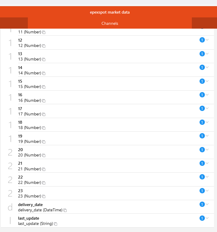

channels:
  - id: data_description
    channelTypeUID: http:string
    label: data_description
    description: ""
    configuration:
      stateTransformation: REGEX:.*?(<h2>.*?</h2>).*∩XPATH://h2
  - id: "00"
    channelTypeUID: http:number
    label: "00"
    description: ""
    configuration:
      stateTransformation: REGEX:.*?(<tbody>.*?</tbody>).*∩XPATH://tr[1]/td[4]
  - id: "01"
    label: "01"
    description: null
    configuration:
      stateTransformation: REGEX:.*?(<tbody>.*?</tbody>).*∩XPATH://tr[2]/td[4]
  - id: "02"
    label: "02"
    description: null
    configuration:
      stateTransformation: REGEX:.*?(<tbody>.*?</tbody>).*∩XPATH://tr[3]/td[4]
  - id: "03"
    label: "03"
    description: null
    configuration:
      stateTransformation: REGEX:.*?(<tbody>.*?</tbody>).*∩XPATH://tr[4]/td[4]
  - id: "04"
    label: "04"
    description: null
    configuration:
      stateTransformation: REGEX:.*?(<tbody>.*?</tbody>).*∩XPATH://tr[5]/td[4]
  - id: "05"
    label: "05"
    description: null
    configuration:
      stateTransformation: REGEX:.*?(<tbody>.*?</tbody>).*∩XPATH://tr[6]/td[4]
  - id: "06"
    label: "06"
    description: null
    configuration:
      stateTransformation: REGEX:.*?(<tbody>.*?</tbody>).*∩XPATH://tr[7]/td[4]
  - id: "07"
    label: "07"
    description: null
    configuration:
      stateTransformation: REGEX:.*?(<tbody>.*?</tbody>).*∩XPATH://tr[8]/td[4]
  - id: "08"
    label: "08"
    description: null
    configuration:
      stateTransformation: REGEX:.*?(<tbody>.*?</tbody>).*∩XPATH://tr[9]/td[4]
  - id: "09"
    label: "09"
    description: null
    configuration:
      stateTransformation: REGEX:.*?(<tbody>.*?</tbody>).*∩XPATH://tr[10]/td[4]
  - id: "10"
    label: "10"
    description: null
    configuration:
      stateTransformation: REGEX:.*?(<tbody>.*?</tbody>).*∩XPATH://tr[11]/td[4]
  - id: "11"
    label: "11"
    description: null
    configuration:
      stateTransformation: REGEX:.*?(<tbody>.*?</tbody>).*∩XPATH://tr[12]/td[4]
  - id: "12"
    label: "12"
    description: null
    configuration:
      stateTransformation: REGEX:.*?(<tbody>.*?</tbody>).*∩XPATH://tr[13]/td[4]
  - id: "13"
    label: "13"
    description: null
    configuration:
      stateTransformation: REGEX:.*?(<tbody>.*?</tbody>).*∩XPATH://tr[14]/td[4]
  - id: "14"
    label: "14"
    description: null
    configuration:
      stateTransformation: REGEX:.*?(<tbody>.*?</tbody>).*∩XPATH://tr[15]/td[4]
  - id: "15"
    label: "15"
    description: null
    configuration:
      stateTransformation: REGEX:.*?(<tbody>.*?</tbody>).*∩XPATH://tr[16]/td[4]
  - id: "16"
    label: "16"
    description: null
    configuration:
      stateTransformation: REGEX:.*?(<tbody>.*?</tbody>).*∩XPATH://tr[17]/td[4]
  - id: "17"
    label: "17"
    description: null
    configuration:
      stateTransformation: REGEX:.*?(<tbody>.*?</tbody>).*∩XPATH://tr[18]/td[4]
  - id: "18"
    label: "18"
    description: null
    configuration:
      stateTransformation: REGEX:.*?(<tbody>.*?</tbody>).*∩XPATH://tr[19]/td[4]
  - id: "19"
    label: "19"
    description: null
    configuration:
      stateTransformation: REGEX:.*?(<tbody>.*?</tbody>).*∩XPATH://tr[20]/td[4]
  - id: "20"
    label: "20"
    description: null
    configuration:
      stateTransformation: REGEX:.*?(<tbody>.*?</tbody>).*∩XPATH://tr[21]/td[4]
  - id: "21"
    label: "21"
    description: null
    configuration:
      stateTransformation: REGEX:.*?(<tbody>.*?</tbody>).*∩XPATH://tr[22]/td[4]
  - id: "22"
    label: "22"
    description: null
    configuration:
      stateTransformation: REGEX:.*?(<tbody>.*?</tbody>).*∩XPATH://tr[23]/td[4]
  - id: "23"
    label: "23"
    description: null
    configuration:
      stateTransformation: REGEX:.*?(<tbody>.*?</tbody>).*∩XPATH://tr[24]/td[4]

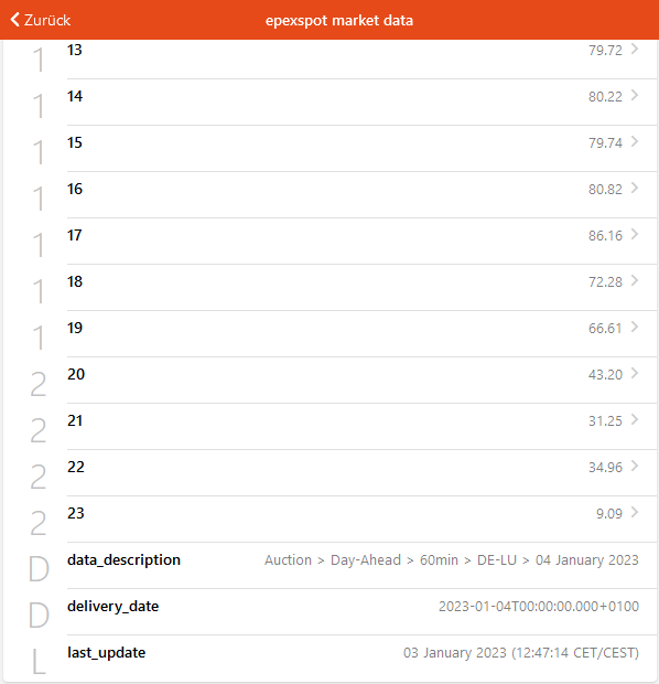

  - id: delivery_date
    channelTypeUID: http:datetime
    label: delivery_date
    description: ""
    configuration:
      stateTransformation: REGEX:.*?data-head="(.*?)".*∩REGEX:s/(\d\d)\.(\d\d)\.(\d\d)/20$3-$2-$1/g
  - id: last_update
    label: last_update
    description: ""
    configuration:
      stateTransformation: REGEX:.*?Last\supdate\:(.*?)<.*
