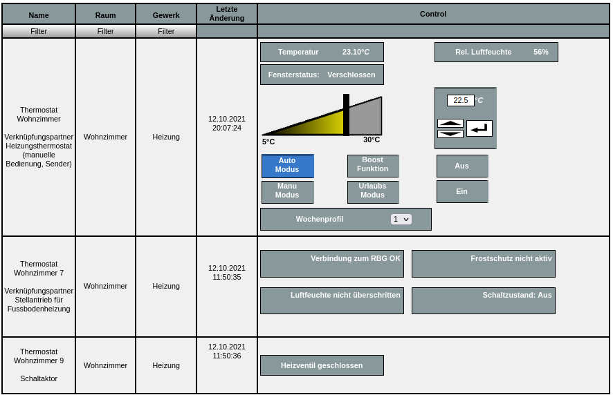

Disclaimer 2: The only things I wanted to have inside openHAB are a) switch from manual to automatic mode, b) in manual mode see and change the set point temperature, c) in automatic mode see and change the set point temperature temporarily, d) see and log the status of the valve, and e) see and log current temperature, and current humidity. There are lots of other things which the thermostat could do (Boost mode etc), but I’d leave that to the native CCU2-interface.
Solution:
These are the channels which I identified as crucial to do the job:
  • 1#HUMIDITY: Easy, current humidity
  • 1#ACTUAL_TEMPERATURE: Also easy, current temperature
  • 9#SWITCH: I’m still not sure what the other (identically-named) channels represent, but this one appears to represent the valve-status (0 = closed, 1 = open)
  • 1#SET_POINT_TEMPERATURE: That’s what I found to be the temperature with which I can control the manual mode or, alternatively, override the automatic mode until the temperature is re-set again (typically at midnight depending on the programming). Adding a listWidget item (via “add metadata”: “Stepper List Item”) with min=5, Max=30 and step = 0.5 makes it look nicely.
  • 1#CONTROL_MODE: From what I can see, 1 represents “Manual mode” and 3 represents “Automatic mode”. Thus I added the state description with “1=Manual” and “3=Automatic” under “options” and the “oh-label-item” as a a listWidget item, to allow me to change between the two modes. As said, I’m ignoring Boost- and Vacation mode, so probably 0 or 2 also have a meaning.
