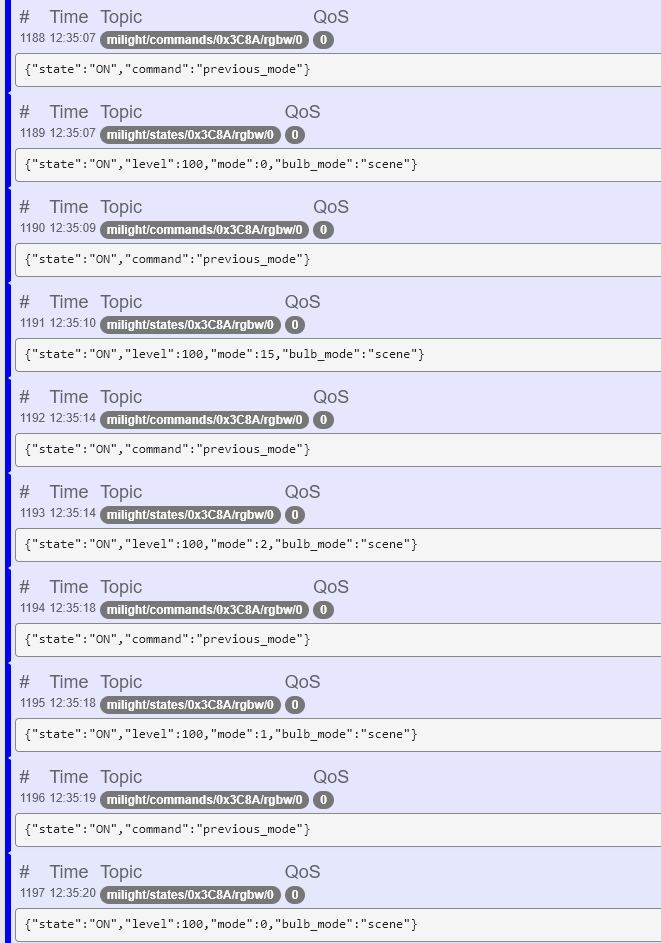

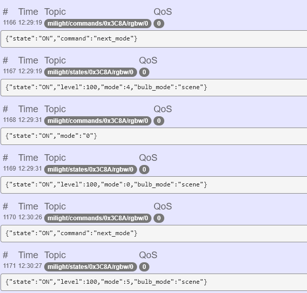

  1. Command: set_white and night_mode, works for my bulbs (RGBW).
  2. Command: next_mode it works, the mode changes from 0 to 8. But if the mode is changed through the mode, as I showed above: {“state”:“ON”,“mode”:“‘+Milight_ID1_G1_mode.state+’”}, then this command will continue from the place where it finished, and not from the last mode. Eg:
  3. Command: previous_mode, changes mode 15,2,1,0,15,2,1,0 etc

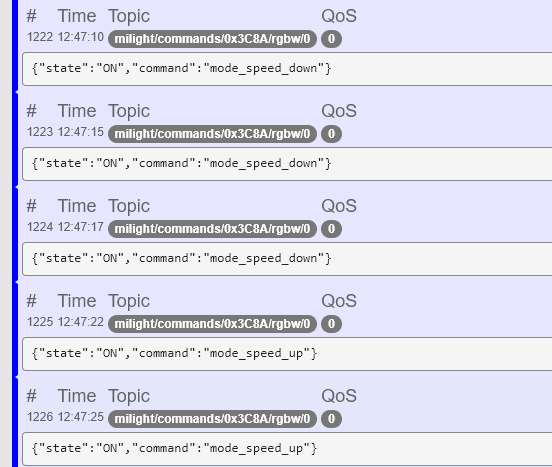

  4. Command: mode_speed_up and mode_speed_down, works, but it is not clear, the current state, what is the range from the minimum to the maximum? mosquito does not return status:
