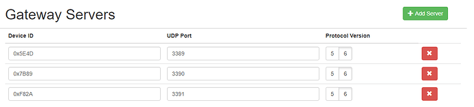

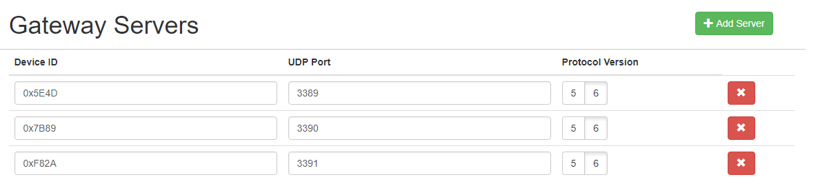

So for those interested, after you got the hardware and connected everything together (really simple to do), you configure as many virtual gateways as you want. The project includes a “sniffer” mode which you can use to identify your existing gateway’s IDs, i.e. the ID to which bulbs subscribe when you initially linked them up. Using this sniffer it relatively easy to create the virtual gateways and means that your existing bulbs remain exactly as-is, no reconfiguration needed!
The only caveat is to ensure that you configure the OH2 MiLight binding with the correct thing type. I used to use the rgbLed, but with the virtual gateway I simulate a V6 bridge and for this I use the V6 Milight binding’s channel and the rgbwLed thing. This combination works like a charm.
Here’s an example of the gateway configuration:
