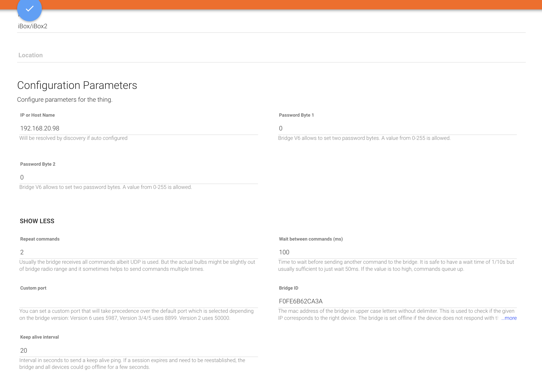

Hi !
I´m new to openhab2 and i´m trying to use the milight binding with my ibox2 Bridge. I installed openHABian on a Raspberry Pi and switched to the unstable release tree in the config tool. Then i restarted the raspi and installed the milight binding (binding-milight - 2.2.0.SNAPSHOT).
When I try to add the IBox2 as a new “thing” it starts an automatic search, but does not find my ibox2. Then I added the ibox manually by entering its IP- and MAC-Address. After that it shows me the ibox2 as Online. Now I tried to add my Milight Controllers FUT036 (CCT only) & FUT028 (4 Channel RGBW) without success. Is it possible, that these Controllers are not supported by the Binding ?
