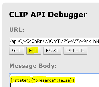

Also when you are using the Hue CLIP API Debugger you can simulate arrival and departure like this:
OR conversely using
{"state":{"presence":true}}
or
{"state":{"presence":false}}
So you don’t need to leave your house to test your rules.
